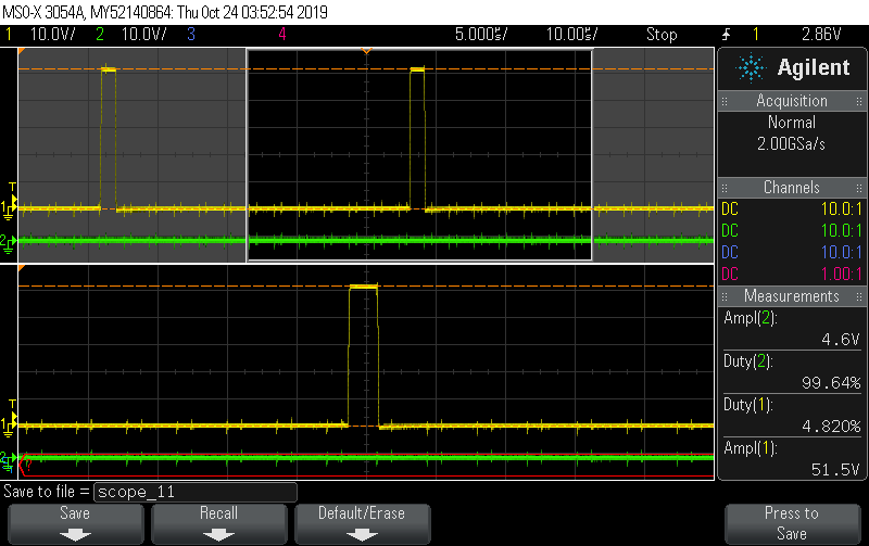

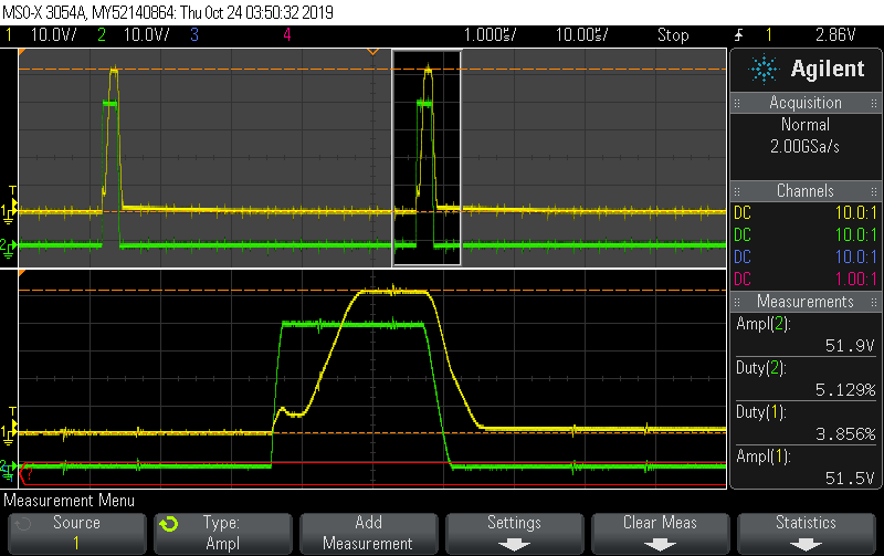

  • Hi Rick,
    Probing the output pins does seem quite revealing. When moving forward (the direction that works), I get PWM on the active channel and nothing on the inactive one, but when moving in reverse I actually get PWM on both channels. See following scope captures, taken at 5% duty cycle pwm (I'm running at 22kHz):
    FORWARD MOVE:
    REVERSE MOVE:

  • Hi Ryan,
    Thanks for the information.
    The SRC12 should be connected to SRC34 in your schematic. Please refer to section 7.2 (Functional Block Diagram).
    Without this connection, there is no path for the current to flow through the low side FETS in OUT1/OUT2.
    Once this connection is made you should see the desired operation.
