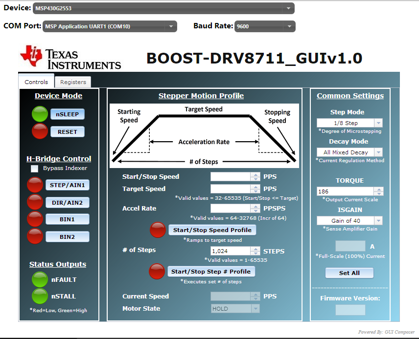

I am trying to use BOOST-DRV8711 and MSP-EXP430G2ET to drive a bipolar stepper motor. I followed all steps in the user guide. When I connected power source to BOOST-DRV8711, even if the current was limited under 0.1 A by the power source, "FAULT" light was on once the voltage exceeded 4V. Is it normal?
Also, when I connected the boards to my computer and opened GUI, there was no error reported. I assumed GUI and the boards were successfully connected. But GUI couldn't read the firmware version of my boards. There was no response when I clicked "START/STOP" button. It was always RED.
Do you know how to solve the problems and make the driver work?

  • Hi Siyuan,
    The delay could be the reason, but to confirm please try the following:
    1) Once the GUI is connected as shown in your image above, toggle the nSLEEP pin or DIR pin and watch the voltage change at the launchpad GPIO pins. The BOOST-DRV8711 does not need to be connected. If the GPIOs are changing, then communication delay is most likely the reason. If not, there could be other problems.
    If it works, communications from GUI to mcu is very slow. We have seen delays exceeding 60 seconds versus typically 1 second on the previous MSP-EXP430G2.

  • Hi Rick,
    I tested GPIOs when I toggled nSleep/DIR. They didn't change. So there are actually other problems. But anyway, BOOST-DRV8711 cannot normally work with any LaunchPad you are currently selling, even from your side, right? If it is true, we need to find another driver to drive our motor.

  • Hi Siyaun,
    The BOOST-DRV8711 works well with the MSP-EXP430G2 launchpad. It does not work well with the MSP-EXP430G2ET launchpad. We will be testing the MSP-EXP430F5529LP early next week.

  • Hi Siyuan,
    Unfortunately, the added delay introduced in the MSP-EXP430G2ET creates too much delay in the communication path between the GUI and EVM.
