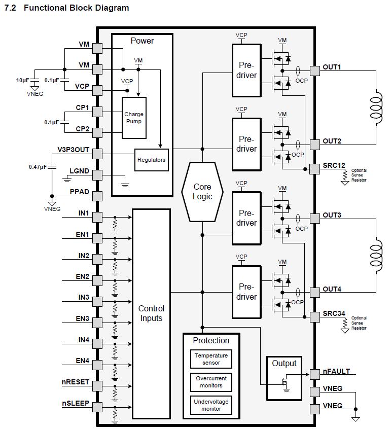

Hi team,
My customer has the concern if DRV8844 can support to low side sensing by adding a resistor on the ground pin to achieve closed loop control? It seems every inside bridge shares the same ground?
Thanks.
