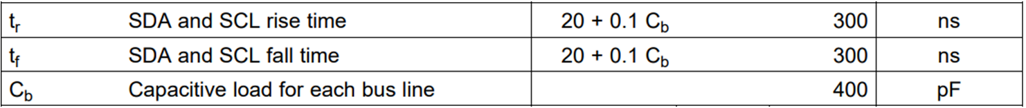

Regarding DRV2604L
Could you please let me know the I2C Rise time/Fall time requirements?
