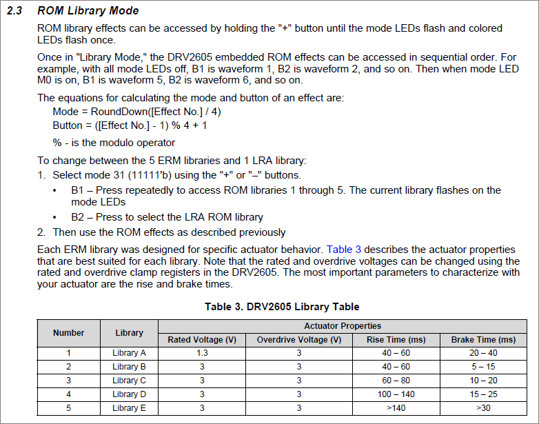

  • Hi Luis
    If without the USB2ANY,can I use the DRV2605EVM-CT?  What is only few EVM boards?
    If let the DRV2605EVM-CT can work,what conditions are needed?
    Do you have a contact information?
    Sorry for the confusion. Yes, all the EVM boards can be used without the USB2ANY tool. As mentioned in their respective User's Guides, they have multiple demo modes. However, if you would like to configure the DRV2605 by yourself and test more specific functions, you can use the USB2ANY and the GUI.
    Luis Fernando Rodríguez S.

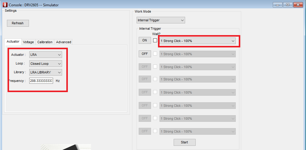

  • Hi Luis
    1.As shown in the red box below, why can't it be set as USB all the time?
    2.How to access 123 waveform library? How to access 123 waveform Library in LRA library?I can't play it according to the instructions.
    What is the mode 31(11111'b)?
    Please take a look at my responses below and let me know if you have additional questions or comments on this.
    The DRV2625EVM-CT needs to be configured in GUI mode before opening the GUI. As mentioned in section 3.3 of the User's Guide, the EVM needs to access to GUI mode by holding down the '+' button for approximately 3 seconds.
    http://www.ti.com/lit/ug/slou432a/slou432a.pdf#page=8
    Once the EVM enters in GUI mode, you should be able to see the EVM detected in the GUI main window.
    The 123 LRA waveform library can be accessed in closed loop only. You would need to select the LRA mode in the GUI and then the closed loop as shown in the picture below. The 123 effects can be displayed in the subtabs of the internal trigger section:
    3. What is the mode 31(11111'b)?
    Mode 31 is only used to verify the device details such device ID, silicon revision and code revision. This is just for information purposes. The device ID version can be also found in status register (0x00).

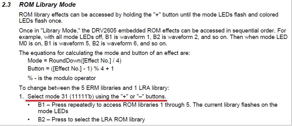

  • Hi Luis,
    1.I still can't set it as USB, is it related to FW(My FW is the initial)?Are there setup steps?
    2.How to set it to 31 mode? What's the indication?
    I have additional questions about this.
    - Which Windows version are you using?
    - Are you using the USB2ANY tool?
    - How the EVM jumpers are configured?
    - In the Haptics Control Console, if you go to the Help Tab, then to the Firmware Update option, are you able to update the firmware?
    Regarding your question about the mode 31, you would need to access to the Binary counting mode first as mentioned in the User's Guide. Once the EVM is powered up, you would need to press and hold the increment mode button ('+') for approximately 3 seconds until the mode LEDs flash and the colored LEDs flash once. You would need to repeat this action one more time. Then, you would be in the binary counting mode. Finally, select the "demo" modes using the '+' and '-' buttons. You would be in mode 31 until the mode LEDs are in 11111. For more details, please go to section 3.1 of the User's Guide:
    http://www.ti.com/lit/ug/slou348b/slou348b.pdf#page=14

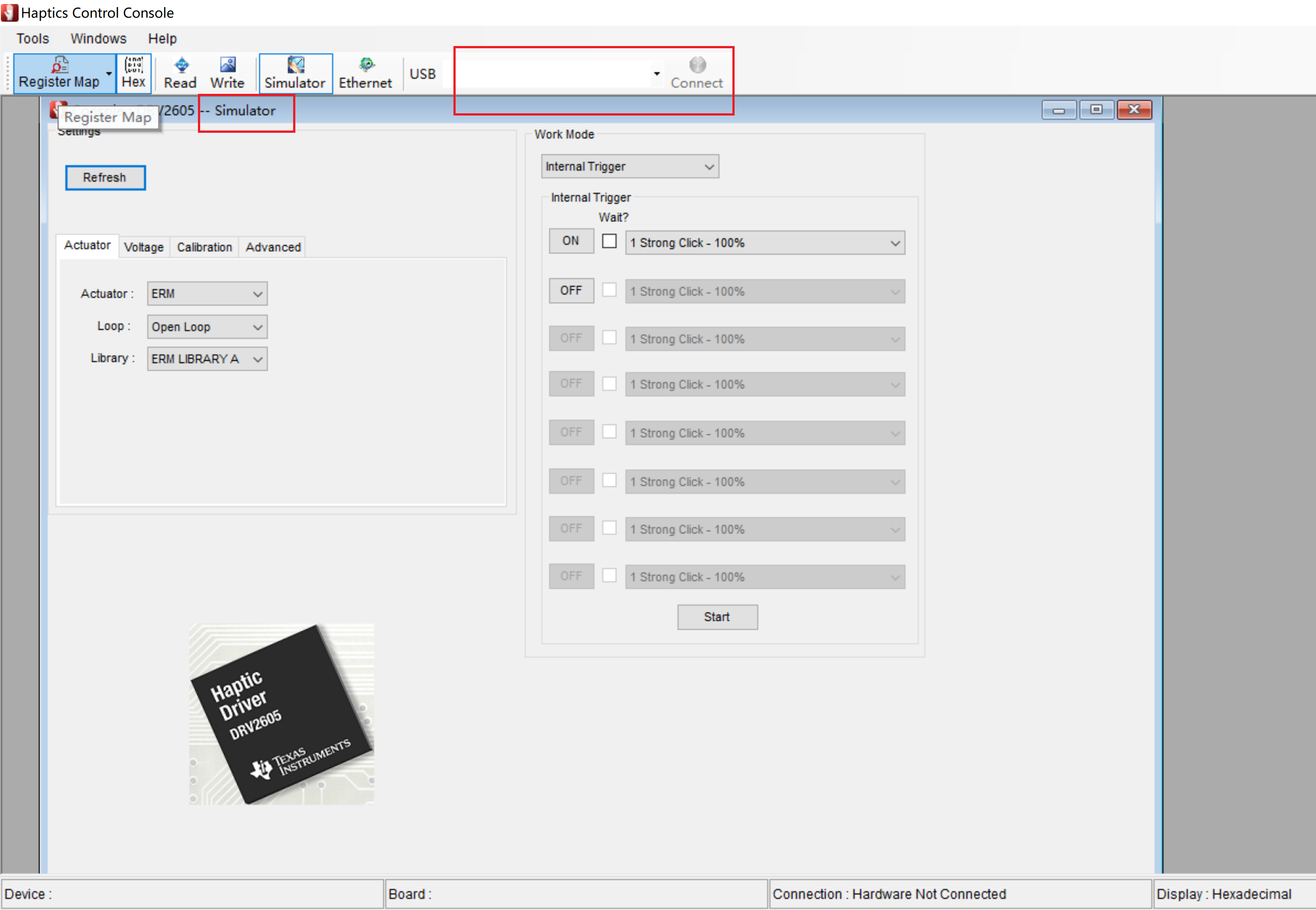

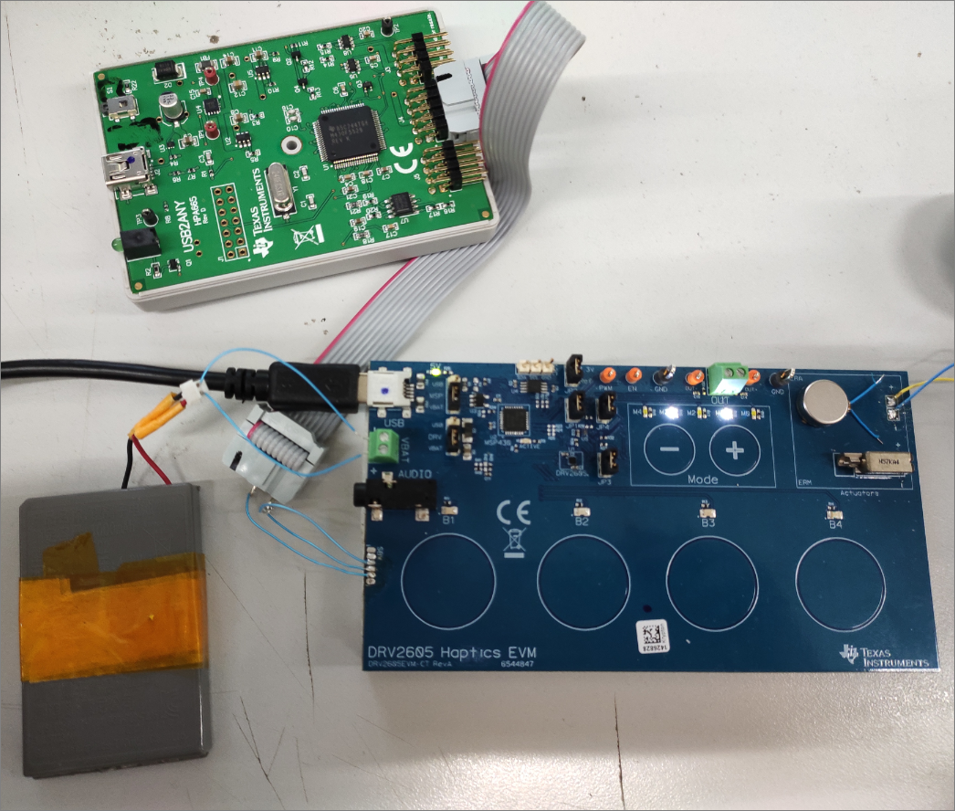

  • Hi Luis
    which Windows is it supporting?
  • After FW used USB2ANY,I still can't set it as USB using USB2ANY
    Could you provide details on how are you connecting the USB2ANY? You must modify the jumpers MSP and DRV in order to power on the device from VBAT. The USB cable shouldn't be connected to the EVM when the USB2ANY is connected to the I2C lines.
  • Hi Luis,
    which Windows version is it supporting?
    This application was originally developed for Windows 7. The next versions are also supported but sometimes they present some configuration issues.
  • Hi Luis,
    Because there are few win7 environments,Have you tried to use it on Windows 10?
    Are the following configurations correct?
    Yes, let me do a correction on my previous posts. When the USB2ANY tool is used on the EVM works correctly on Windows 10, the issues come when the EVM is not used with the USB2ANY.
    However, I noticed that you have connected the USB2ANY to the SBW pins directly. I would suggest to connect them to the I2C pins.
    The power pins are correctly connected to VBAT connector.
    Please let me know if you have additional questions or comments on this.

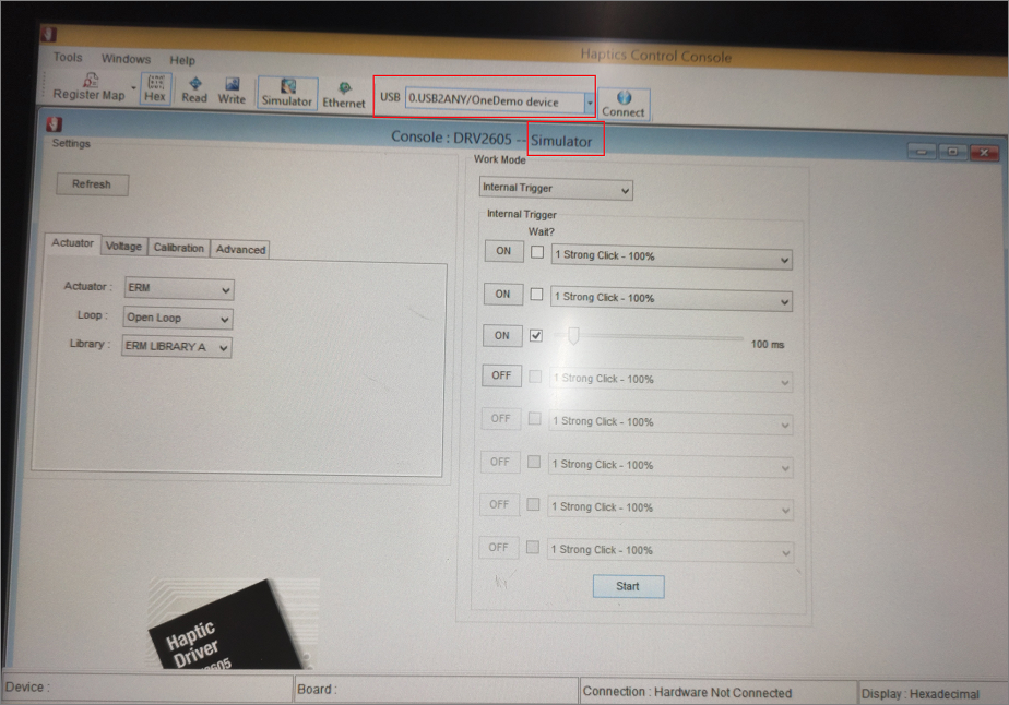

  • Hi Luis,
    1.According to the figure below,,USB2ANY is not required to access ROM Library Mode.
    2.Can the USB2ANY connect to SBW pins only be used to update FW?
    3.The following configuration still does not set it to USB.
    SBW pin is only used for FW update.
    From your HCC capture, it seems your USB2ANY firmware is not updated. It says "onedemo device"
    -Ivan Salazar
    Applications Engineer - Low Power Audio & Actuators
  • Hi Luis
    What I care about most is how to set it as USB? Please help.
  • You should follow instructions from section 6 from this appnote to update the firmware of the USB2ANY board.
    Once firmware is updated, you should be able to connect it to Haptics Control Console.
    -Ivan Salazar
