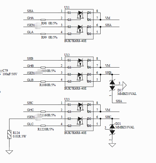

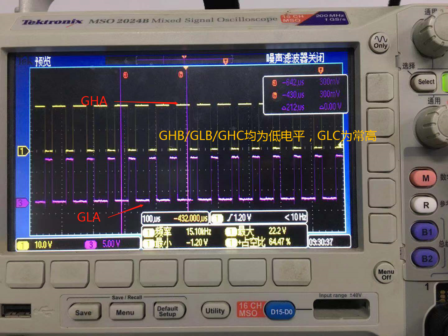

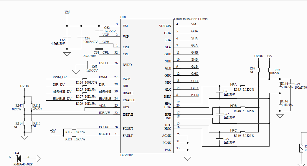

Hi Team
My motor couldn't start up normally using myself DRV8306 board.  But If i use hand to touch motor, Maybe it can start to run. Do you has any suggestion how can I run it?  I have EVM at hand, it can driver motor normally.
power supply voltage is 12.5V, the driving frequency is 15kHz, and the duty ratio is 65%. When driving a 12V motor, the motor does not change phase, the current is about 4A, and the normal should be about 2A. The FAULT foot is reported without failure. Starting state: DIR high level, A: 0 B: 1 C: 1 The following is the test picture
