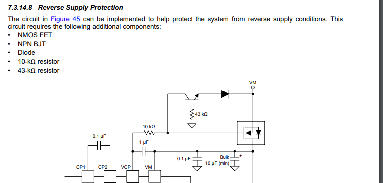

Hello, would it be possible to use the "VCP" pin of the DRV8840 to perform reverse supply protection, similar to drv8703?
If possible, what would you consider?
http://www.ti.com/lit/ds/symlink/drv8703d-q1.pdf

Hi Milordy,
Yes, it should be possible to do this. Please allow me to confirm with the design team. We should have a response be Tuesday.
Hi Milordy,
Sorry for the delayed response.
Yes, this configuration should work.
