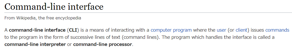

Hi, Wang,
The command line is defined as follows,
Please show the detail, https://en.wikipedia.org/wiki/Command-line_interface#Command_prompt
I know that the GUI Tool has the "Reciprocate" mode. But the control pattern of this mode is very simple. The customer want to operate continuously with the complex control patterns.
The cycle testing is similar to the life testing.
The MSP430 is embedded in DRV8886EVM. Can the customer control using MSP Flasher instead of the MSP430 on the EVM?
