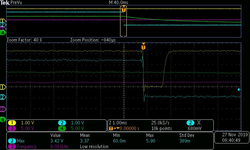

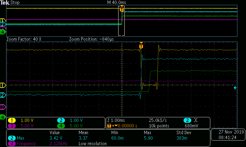

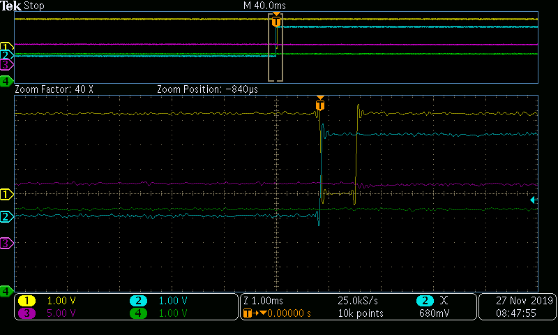

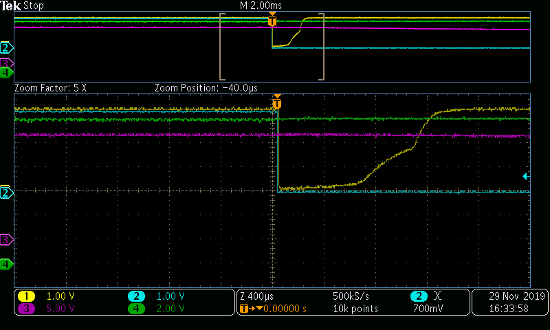

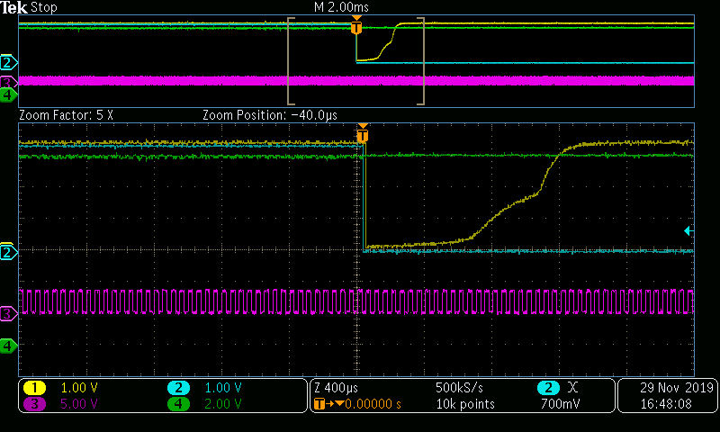

When the bridge is activated or deactivated the nFAULT pin is pulled low for approximate 1ms before returning high.

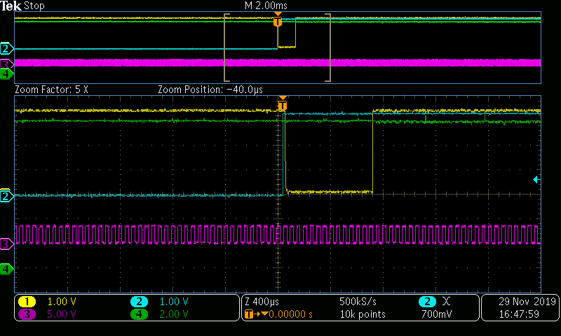

When changing duty cycle or direction, no fault is indicated. No current limiting is in effect since no current chopping is indicated and the fault would be approximately 3ms long, (t-RETRY).

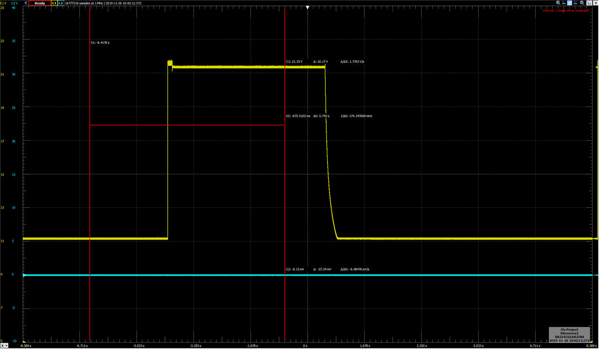

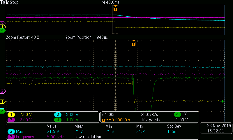

when looking for a potential problem I noticed a strange behavior on the VCP pin. When the H-bridge is disabled the VCP is at 11.2V, but VM is 12V. When the bridge is activated it quickly builds to 21.2V and dropps down to 11.2V when turned off again. Is this a normal behavior?  The device is not put in SLEEP mode. UPDATE: The device IS put in sleep mode. Se further posts.
