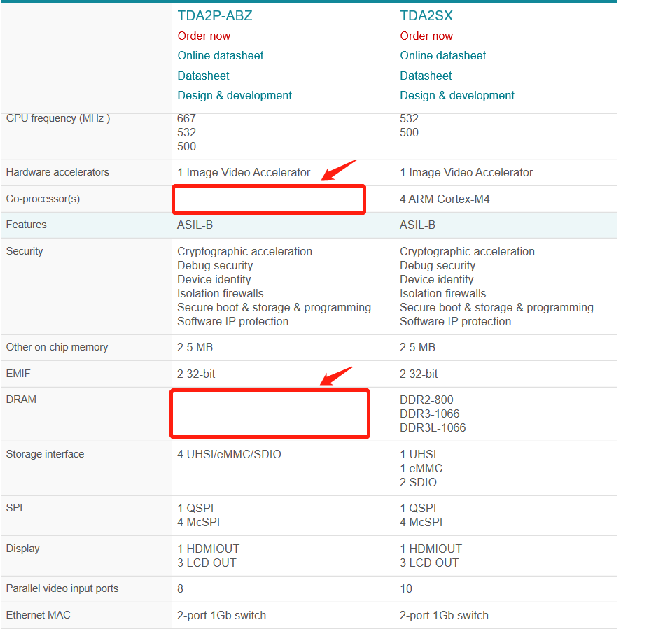

What's the difference between SoC TDA2P-ABZ and TDA2SX?
Other Parts Discussed in Thread: TDA2SX, TDA2P-ABZ

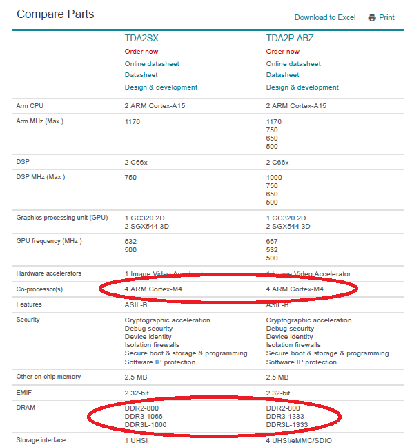

     I want to get the difference between SoC TDA2P-ABZ and TDA2SX, now  I get a excel comparation doc. from link: http://www.ti.com/solution/surround-view-system-ecu.   You can refer to the attachment. from this gernerated excel, there is no "co-processor(s)" and “DRAM” data, but when I refer to the TDA2P-ABZ datasheet, I find dual co-processers in TDA2P-ABZ, so I want the true difference between them!
