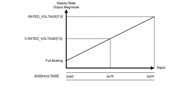

  • Hi, Jack,
    I would recommend to take a look at the picture below for more details.
    The value that the will be stored in address 0x0E corresponds to a percentage of the RATED_VOLTAGE. So, the RTP will be adjusted depending of the RATED_VOLTAGE and the value of address 0x0E.
    Please let me know if you have additional questions or comments on this.
    Luis Fernando Rodríguez S.
  • Dear luis,
         i understand now. many thanks. by the way where you get the figure attached(input - output match)? i can't find in my drv2625.pdf  datasheet  (SLOS879B –APRIL 2014–REVISED SEPTEMBER 2016)
  • Hi, Jack,
    This picture was taken and modified from the DRV2604.
    https://www.ti.com/lit/ds/symlink/drv2604l.pdf#page=24
    We will include this picture in the next DRV2625 datasheet revision.
