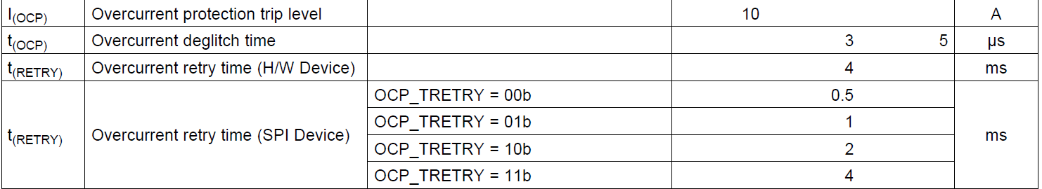

Now our customer will plan to evaluate DRV8873-Q1. Their application draws inrush current when starting up.
They request our device to output 10A. The duration should be more than 0.1s. Ta is 60C.
Q. In case of H-bridge mode(Forward drive : HS1 and LS2 FET are ON), is it possible to output the current?
Q. In case of independent half bridge mode and driving two high-side loads(Low-side drive : LS1 FET and LS2 FET are ON), is it possible to output the current?
