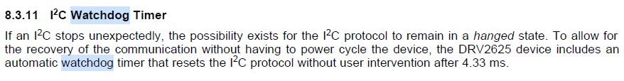

i have seen this in the datasheet,
i'm wondering does this function work automatically? Do i need to connect NRST pin to MCU? Or do i have to enable something in the code?

Hi Mason,
The description says that if I2C communication is stopped suddenly, DRV2625 will reset I2C interface automatically after 4.33ms.
