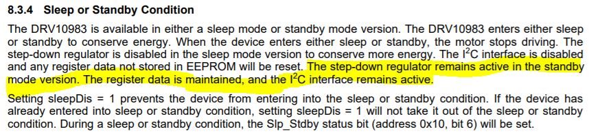

    Generally speaking, 10mA and stable LDOs means the you are using a standby device. As shown in the datasheet, the I2C block of the IC will be active in standby:

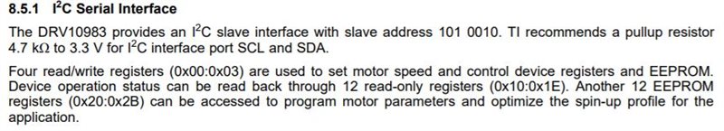

    If you're using the correct slave ID (0b101 0010) as determined in the I2C section of the datasheet and meeting the I2C frequency specifications, then I2C timing is the only reason to be receiving a NACK. Timing is largely determined by the I2C protocol and meeting VIH and VIL specs when the clock is in the correct state. Again, I encourage you to try and consult the programming guide and match the waveform in figure 10.

    To address the other 9 pieces: If all of the regulators are present, then the device's digital logic should be powered. To verify that the logic is executing, place a 3.3V on the SPEED pin and monitor the voltage on a phase pin (U,V, or W). The motor should be disconnected. The device will be brought out of standby in this scenario; even though standby shouldn't be a problem as mentioned in the datasheet text above. "When the device enter sleep or standby, the motor stops driving... The step down regulator remains active... [In] standby... the I2C interface remains active".
