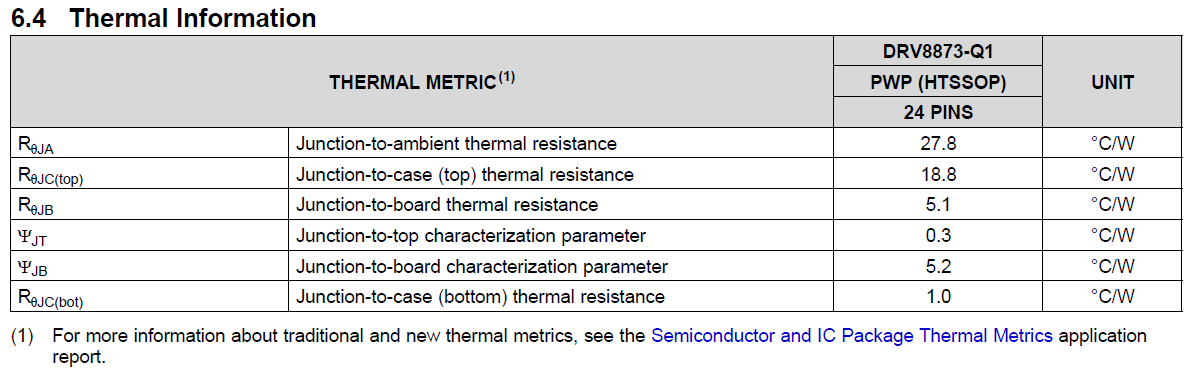

I want to change the drv8432 to drv8873 to get cost down.
I know drv8873 has 10A peak current but there is no any spec of contineous current in the data sheet.
May be, it depend on how to adjust the heat think for the chipset.
I want to get high current .. countineous 4 ~ 5A but the package is so small.
Even though its peak  current spec is 10A, I wonder if it is possible to get 5A.
So I purcharsed the EVM kit from TI site. it doesn't arrive at me yet.
I hope that anyone advise to my plan.
  • KW,
    The continuous output current capability is related to the board thermal performance. The thermal performance is decided by PCB layout; ambient temperature; PWM frequency... To evaluate or estimate the thermal performance, please set the maximum input voltage; maximum PWM frequency; highest ambient temperature. And then, run your board to see at what is the maximum load condition when the board or DRV8873 gets the maximum allowing temperature?
    Also, if you know the thermal resistance and the device temperature, you can estimate the DRV8873's power loss at that certain load condition.

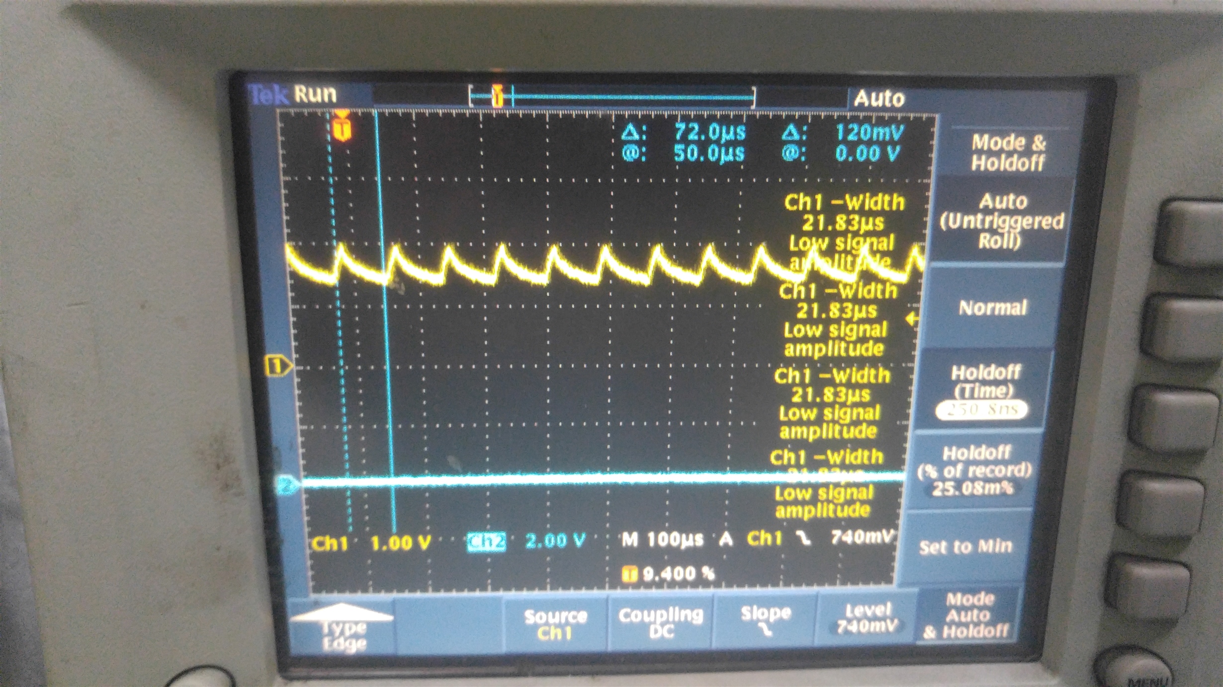

    Can you measure the winding current and IPROPIx signal in a same scope? I would think the IPROPIx voltage low may caused by low winding current or a narrow current pulse.
  • Wang,
    What does the winding and narrow pulse mean?
    Does the narrow pulse mean pwm pulse? PWM frequency is 12KHz. about 80usec period.
    I don't know what the winding' mean is. The load is a coil of solnenoid type.
    Refer to my test bed capture.
    1. current wave capture
    2. test bed block
  • KW,
    1. IPROPIx reflects the high side FET current.
    2. What SR setting do you have? From your test waveform, the solenoid winding current goes up sharply (maybe only few us). If SR setting is too low, IPROPIx may miss that current info.
    3. How do you drive the current going up sharply and going down slowly? If the solenoid winding current in falling period doesn't go through the high FET. IPROPIx doesn't have output.
  • Hi, Wang,
    After I changed SR to NC state(High Impedance), the sensing wave was out.
    Refer to captuer wave.
    But it seems to be difficult for me to use the sensing signal for my unit.
    because the signal is pulse wave, to use it, it must be synchronized to PWM pulse.
    if we make it to flat by using low pass filter, it is possible to use it for my unit.
    So I have to use other sensing function, for example, a effective hall sensor(ACS724).
    Anyway, thank you again for your helpness.
    good luck..
