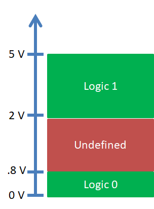

    1) When MCU output signal to DRV, how about  logic-level INPUT 's current? like INHA, INLA, INHB, INLB, INHC,....
    Here is a diagram to better understand the INPUTs logic(INHA, INLA, .....)
    The 100K ohm should not matter much when you are applying a logic low or logic high because it is so large of a resistance.

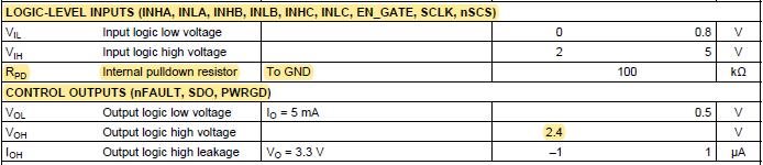

    2) nFault & PWRGD pin is open drain. why here still has voltage maximum data? Does it mean it is not true open drain?
    I agree with you, the spec is a little hard to understand, I will talk to my team and get you a clearer answer. The pin is an open drain output so it should have a logic high of a resistance number rather than a voltage number.

  • Hi Jacky,
    I discussed the questions you raised with my team. The datasheet of the DRV8305 has an error in it. If you look at the DRV8305-Q1 datasheet the table is much clearer:
    the nFAULT pin has a max pull down of 7mA and we do not spec a VOH for it because it is an open drain output.
    Michael
