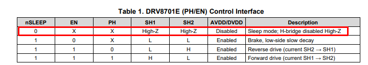

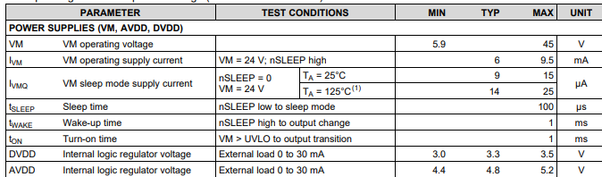

Hello, I was looking at datasheet nSLEEP takes a maximum of 100 us(tSLEEP) to enter SLEEP mode. What I was wondering, and whether this value of 100us would be the same to disable the bridge or would it be another value?

Hi Milordy,
The outputs should be disabled much faster than the 100us, but we will have to research the actual value.
Please expect a reply by Jan 15th.
Hi Milordy,
The time nSLEEP starts falling to outputs Hi-Z is around 13 to 14us.
