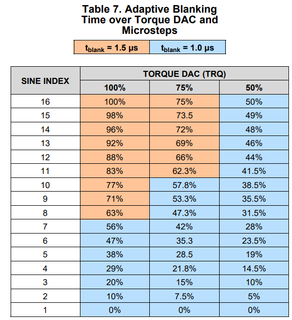

Hi all
Would you mind if we ask DRV8886AT?
On the DRV8886AT's datasheet, there is the Table7.
<Question1>
What does SINE INDEX indicate? microsteps??
<Question2>
And then, XX% means curren value, right?
Kind regards,
Hirotaka Matsumoto

Hi Matsumoto-san,
SINE INDEX is a list of the 16 unique current settings in Table 3. The absolute value of the setting is shown in the list. You can see the values in the 1/16 STEP, AOUT, CURRENT (% FULL-SCALE) from steps 18 to 33.
XX% means % of full scale current.
