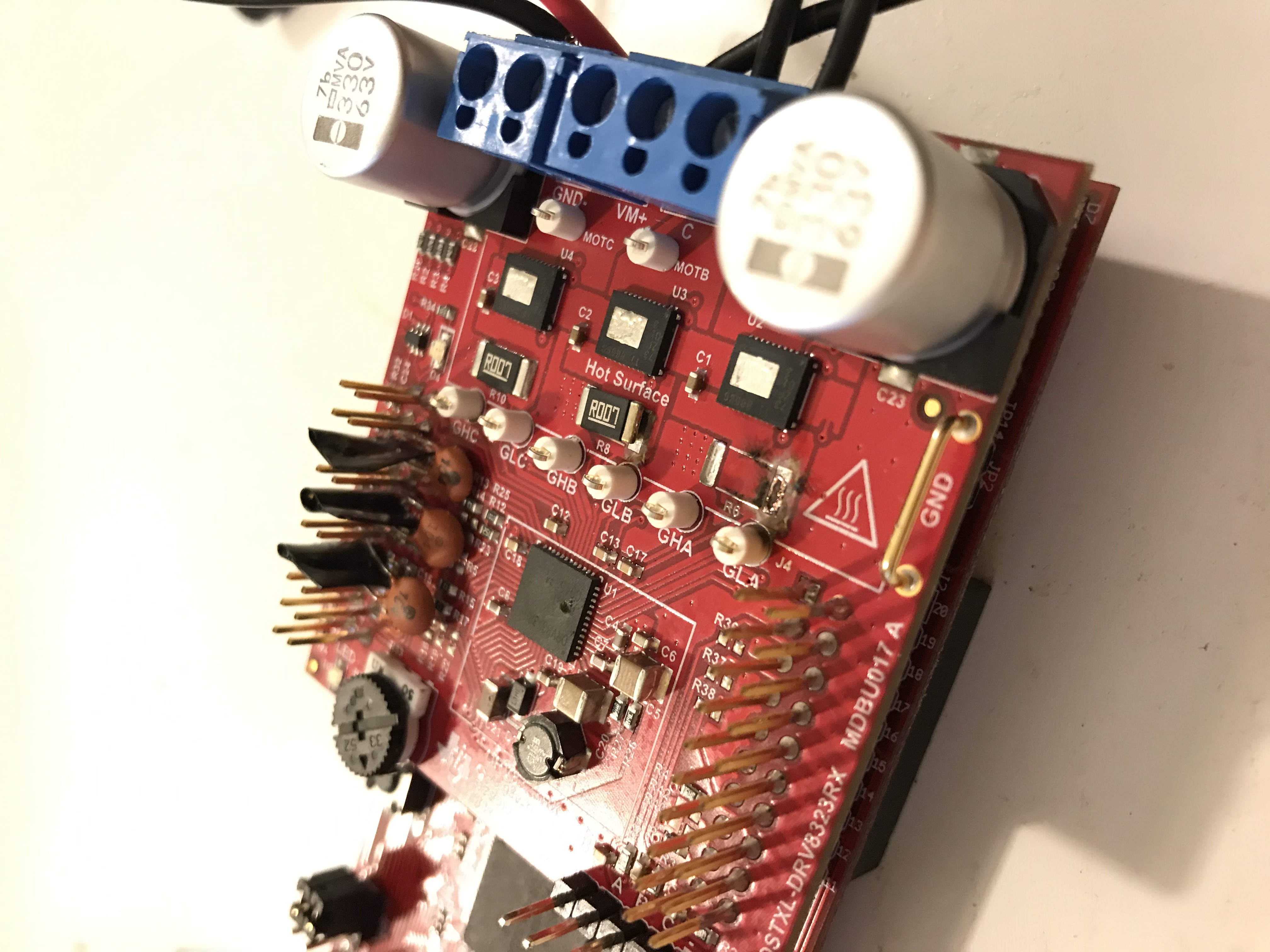

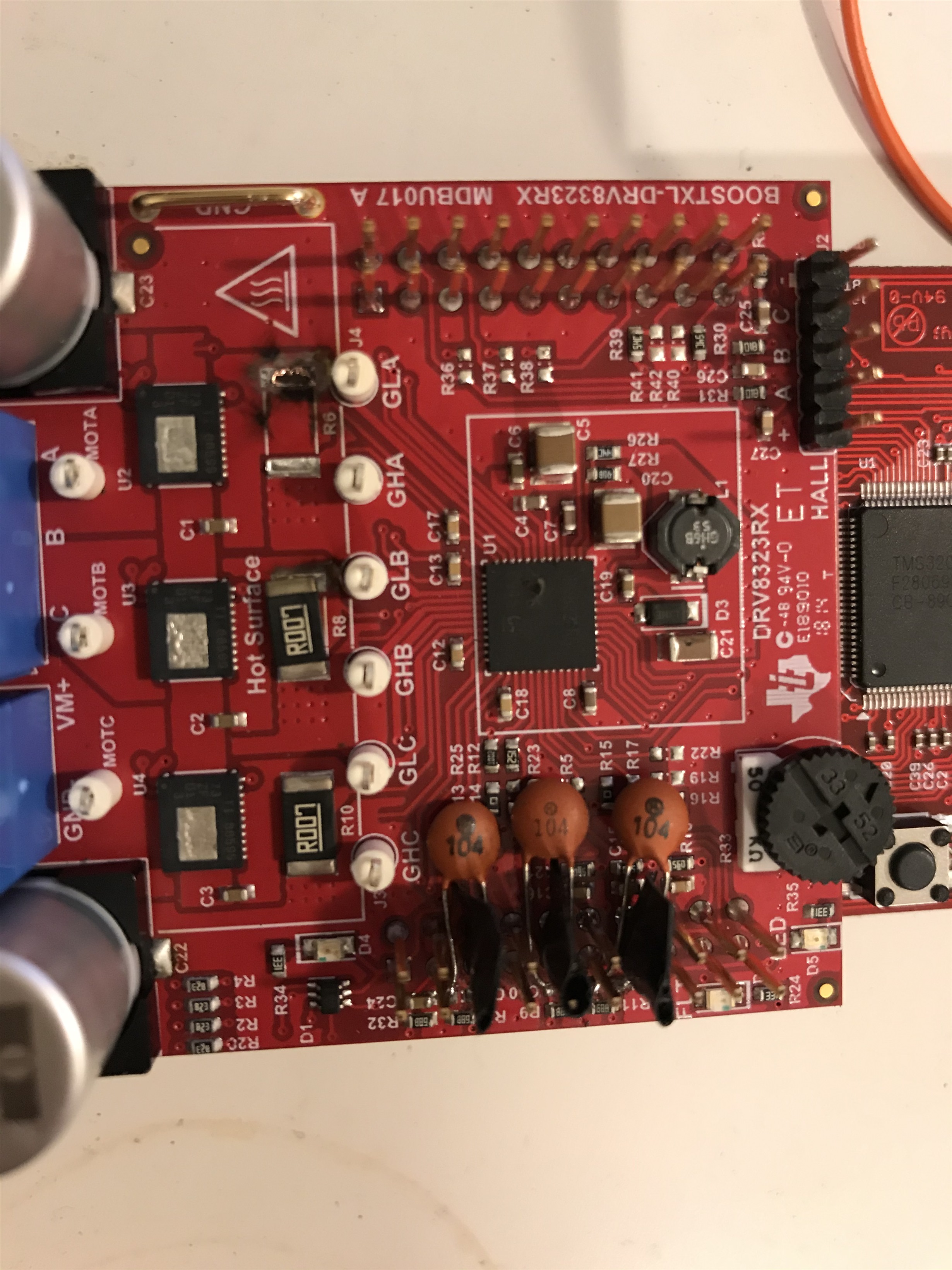

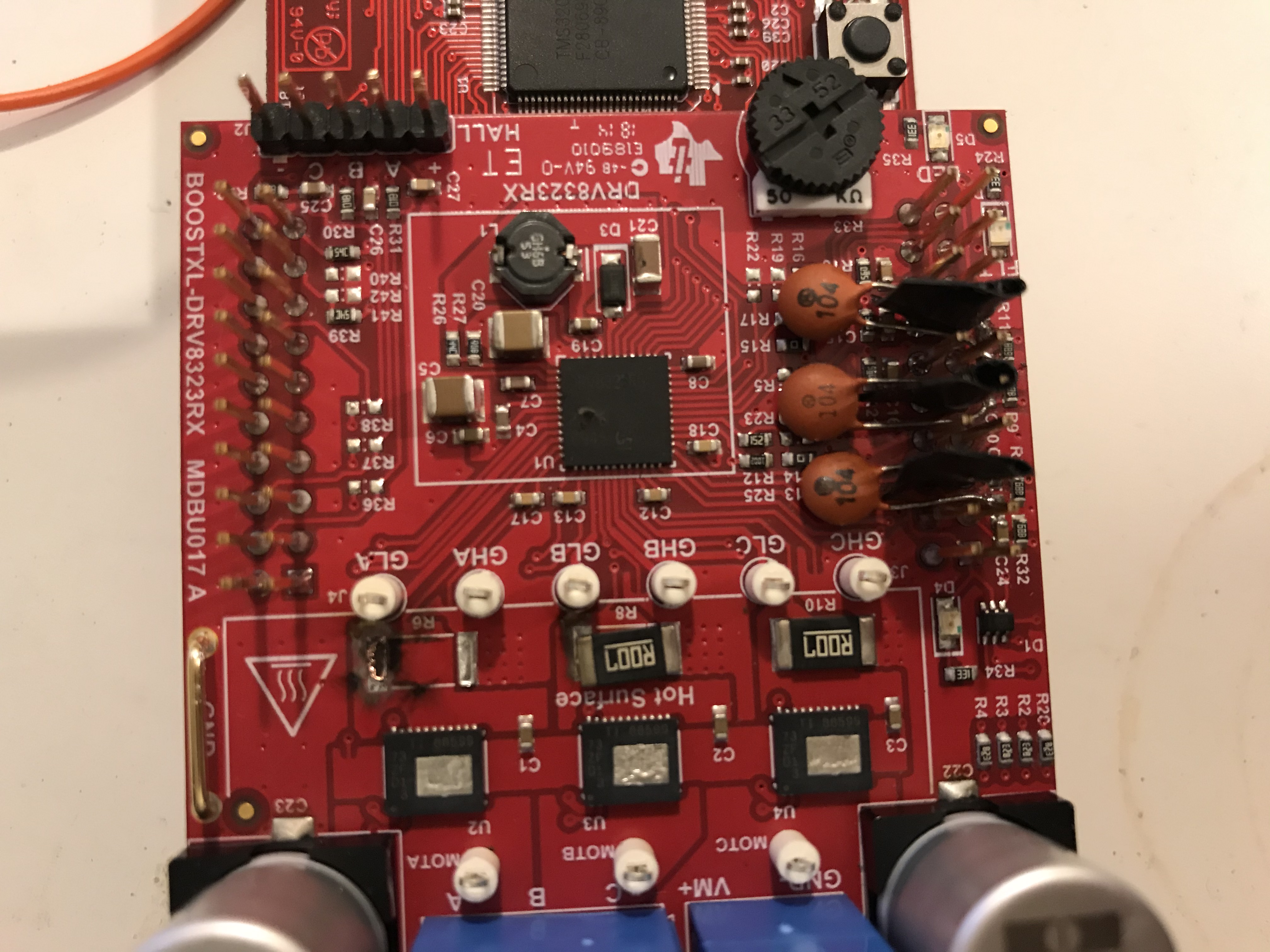

BOOSTXL-DRV8323RS: 28069M DRV Fries and Shunt Resister Explodes Under Semi Hard Load
Part Number: BOOSTXL-DRV8323RS
I have added some custom software in the mainISR in lab 4a to run DRV8323RS stack on top of the 28069M launchpad.

I had an RC controller delivering the signal to the launchpad, and it worked fine for about three-quarters throttle, which corresponds to about 10 amps. The operation is done at 48v. The load I have is like an ebike, and what follows happened when the motor is at rest. I pushed it to up to 15 amps full throttle, the motor makes a loud high-frequency sound for about two seconds and the fault light lights up and the motor becomes disarmed. But I tried it a second-time for full-throttle, 15 amps ref, and the motor made the same sound again with the fault light lighting up but it didn't stop making the noise. I panicked and quickly unplugged the power, then the shunt resistor exploded. I am not sure what happened first (the sparks/explosion or the unplugging), but I think the sparks ignited instantly after I unplugged the power. The DRV also appears to be damaged. The whole process happened in about 5 seconds, from motor noise to evm exploding.
The motor runs under no load, and I am confident that the power and the motor are not the problem.
The 28069m seems to be fine, but the DRV evm definitely seems toasted. The code is programmed in flash if that matters.
This is my second DRV8323RS as I the first one I bought had some problems getting the motor to spin even after I soldered the caps.
  • Zijin,
    I cannot comment on the damage as I cannot review code on E2E nor do I support C2000. The EVM current maximum is near your currents so this may have damaged the board. The hardware was also modified and there was unmanaged energy in the system when the power was removed. Likely without the power the system dumped current into the sense resistor which damaged it.
    I would suggest designing your own system board for higher current evaluation such as this with custom code and hardware changes.
