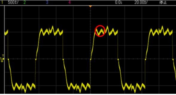

Hi team.
Could you give me your advise on our customer's output current waveform?
The output current seems to be changing from the set value(Risen : 0.2ohm).
My customer's setting is...
VREF : 1.0V
Mode : Full Step(2-phase excitation)/71%
Yellow : The output current
Pink : Visen
Sincerely.

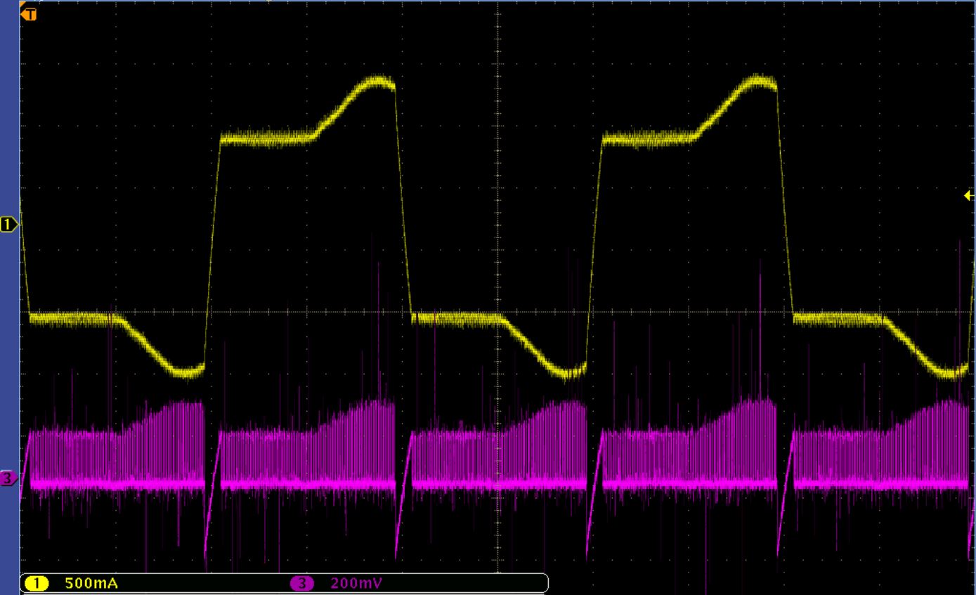

    What decay and Toff setting do they use? If the winding current cannot be driven lower enough during to Toff period with slow decay mode, the winding current could be driven up even with minimum high side FET turn-on time.
    Please set the longest Toff and mixed decay or fast decay mode to see any change on the winding current regulation.
  • Hi Wang.
    Thank you for your reply.
    They use a Slow Decay mode.
    And this phenomenon is only Slow Decay mode.
    So, I think problem is that the motor current flow is insufficient too.
    However, I think there is an toff like bellow the waveform.
    Could you give me some your advice?
    1. Why doesn't our waveform fall ?
    2. How to set the toff on DRV8825 ?
    3. Why is there no current limit ?
    Sincerely.
    Kengo.

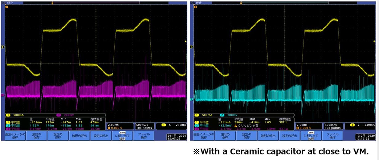

    1. The current ripple could be caused by the input voltage ripple. Please measure the input voltage to confirm it and add more input capacitor to filter it.
    2. Sorry, DRV8825 cannot set different Toff because it has a 30kHz fixed PWM frequency.
    3. "Why is there no current limit?" What voltage is on the input  terminal? What is the winding resistance? What the winding full scale current do you set?
  • Hi Wang.
    I got a below waveform as you said.
    (They added 0.01uF capacitor at close to VM pin.)
    This is their use motor spec.
    The winding resistance : 0.55ohm / Phase.
    https://catalog.orientalmotor.com/item/all-categories/42mm-pkp-series-2-phase-bipolar-stepper-motors/pkp243d15a2-sg18
     FullScale:100% 1.15A
    Their stepping setting : Full step (2-phase excitation) with 71% current)  → 0.86A
    Sincerely.
    Kengo.

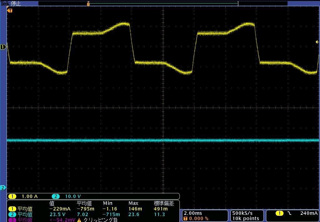

    When you saw the abnormal output voltage, please help me monitor the input voltage also. That is why I want to add more input capacitors to see any output change. Right now, I don't get the waveform with mixed decay, more input capacitor and monitor the input and output voltage. So, I don't have any clue.
  • Wang.
    This is with VM(bule).
    It does not seem to fluctuate.
    Do you think about any other factors?
    If you need any more information, please let me know.
    Sincerely.
    Kengo.
