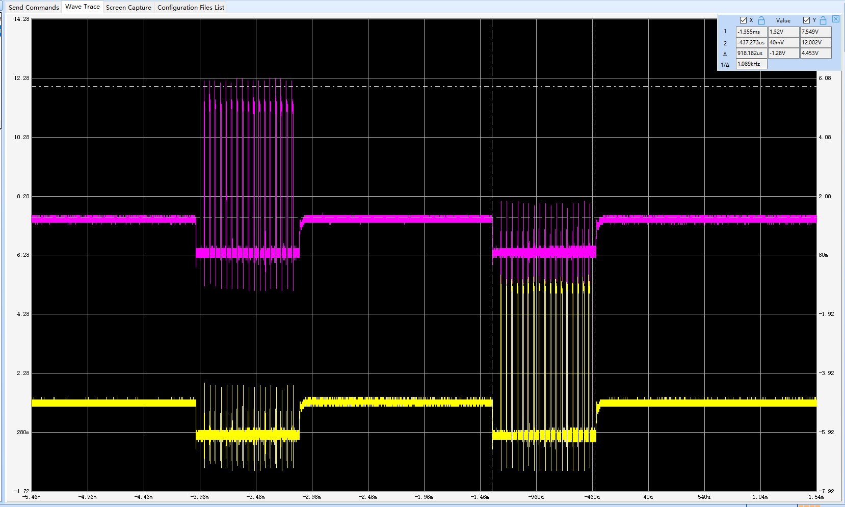

I have a design with DRV2605 drive LRA motor 30ohm, I tried all kind of seqeunces ID#1, ID#2  etc but the vibration is very weak
the voltage looks steady
see below out- and out+  on sequence ID#1
Do you have any idea ?

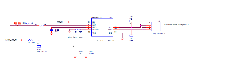

    Could you provide your registers settings and the DRV2605 schematic portion, please? This is to have a better approach to the issue.
    In addition, are you attaching the motor to a solid mass (> 100g)? Are you performing an auto-calibration before using the LRA? Or are you using the device in open-loop mode?
    Any other information you could provide will be appreciated.

    3. see attached files:
      1. Reg.Status.after.configuration
      2. reg.status.after.playing.in.loop
      3. schematic design
