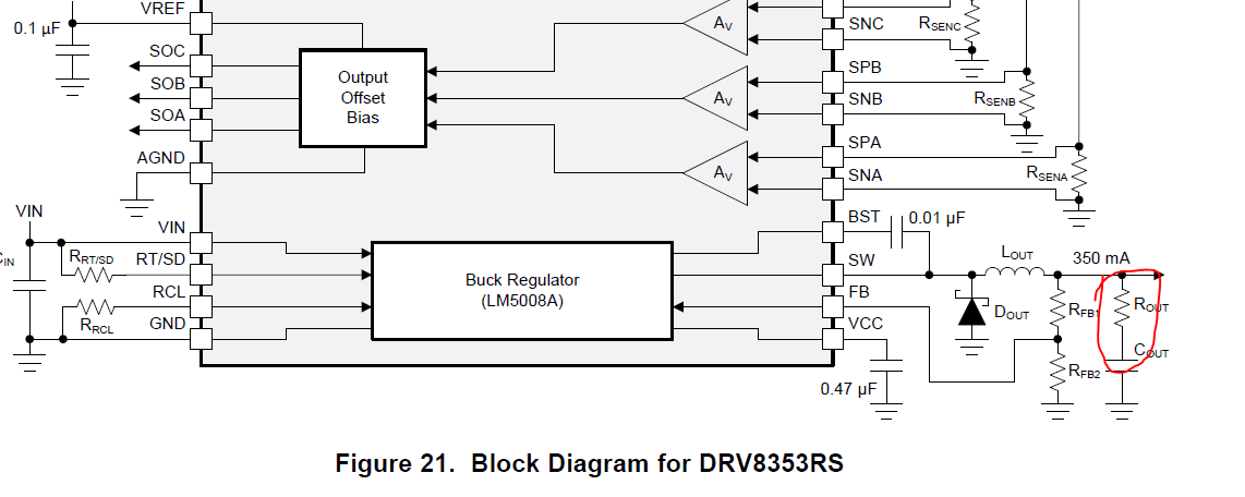

Hi Ti team,
I would like to know if the R-out must needed? If do not have it, will there have any risks?
Thanks!

Hi Bruno,
The LM5008 is a COT device which relies on voltage ripple to properly regulate. Since ceramic capacitors had very low ESR a series resistor is required to cause more ripple and proper regulation.
Ethan
Hi Bruno,
25mV ripple is hard recommendation to ensure stability of the device. The problem with hysteric control is that if the ripple is not large enough, the device can oscillate in between states and cause instability.
There are other ways of ripple injection such as type-3 where the output voltage ripple will be minimal (http://www.ti.com/lit/an/snva874/snva874.pdf). This does have the highest BOM cost solution, but the lowest voltage ripple at the output.
Hope this helps,
Ethan
Hi Bruno,
It is possible in load transient conditions that oscillations can exceed voltage limits on devices it is connected to.
Ethan

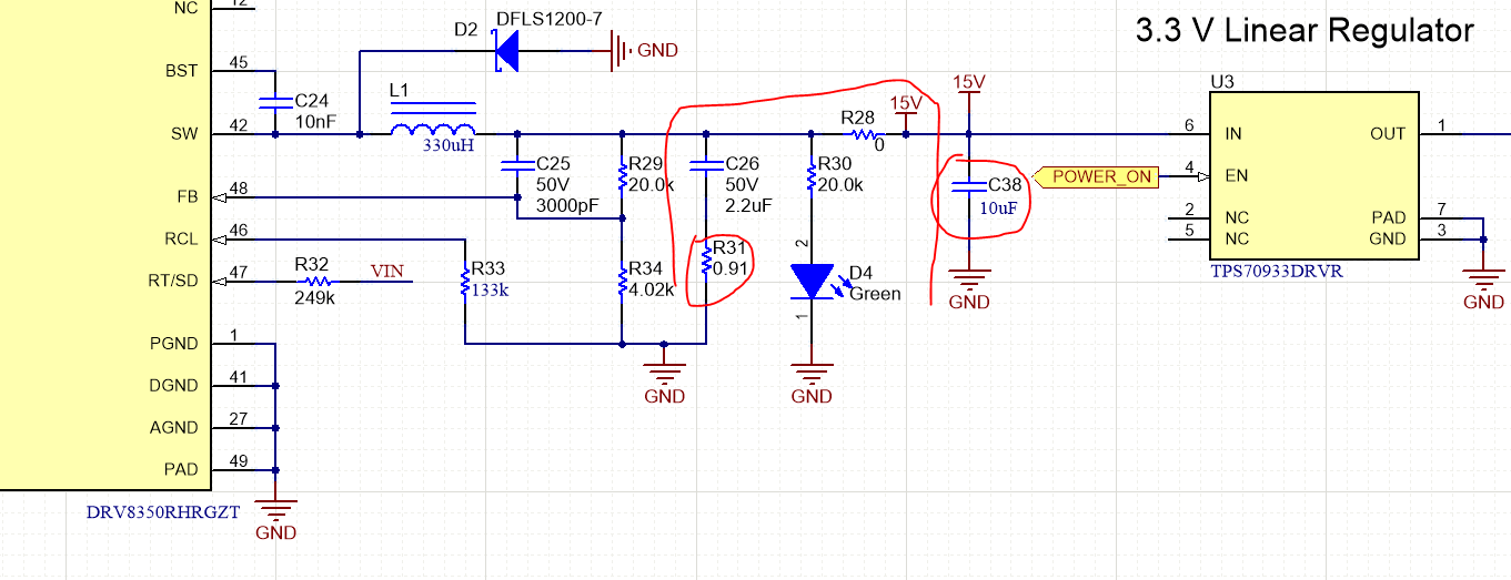

Hi Bruno,
The parallel capacitance will affect the ripple. The article below gets more into detail.
However, I am not worried since you have a feed-forward capacitor which makes this a type-2 ripple generation. The capacitor is AC-coupled with the voltage ripple to the FB node so the actually vout ripple does not need to be significant. Follow this app report below for more information:
http://www.ti.com/lit/an/snva776a/snva776a.pdf
Ethan
