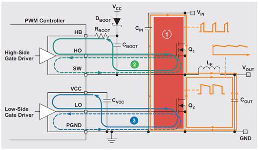

    You can also optimize the layout to reduce the loop 1, 2 and 3 area. The general layout guide can be found in http://www.ti.com/lit/an/slva959a/slva959a.pdf

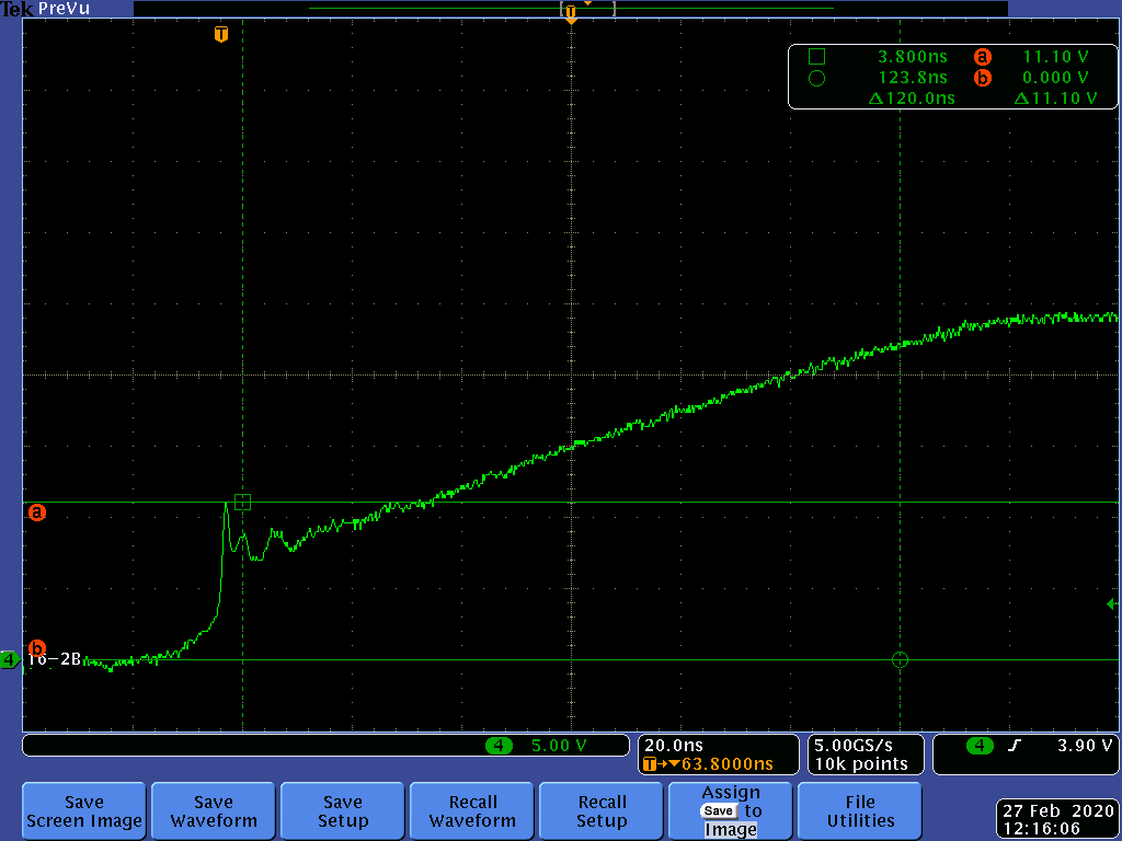

    The EMI is very likely a secondary symptom of the DRV8813's output - see scope plot below.
    It has a very fast rising edge up to around 10 volts, where it then "falters" down to around 7 volts and oscillates before rising slowly and cleanly to the 24V steady on-state.  I would like to understand what is causing this "messy" rising edge - is it something about how I've implemented the DRV8813, or is it something to do with the motor it is driving, or ???

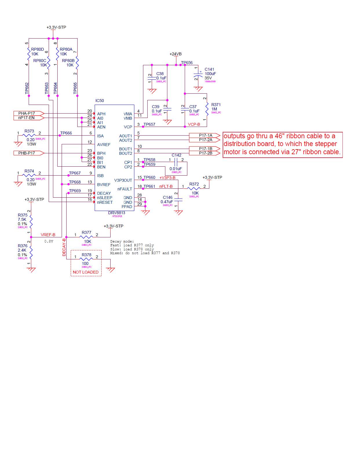

  • Additional info:
    Here is the schematic of my DRV8813 implementation, and the specs for the motor it is driving, in case this helps with your response.
    thanks
  • Gregg,
    "It has a very fast rising edge up to around 10 volts, where it then "falters" down to around 7 volts".
    It seems reasonable to me. During the transition from low side FET turn-off to high side FET turn-on, the high FET and low FET cannot be  turned on at same time. So, it is a dead time to keep both FET off. During that dead time, the switching node voltage is quickly charged up by the load winding current (To verify it, you can change the load current to see the slew rate change).
    If you have approved this ringing is the EMI noise source (the ringing frequency shows up on the EMI test result.), you can add snubber to slow down the slew rate.
