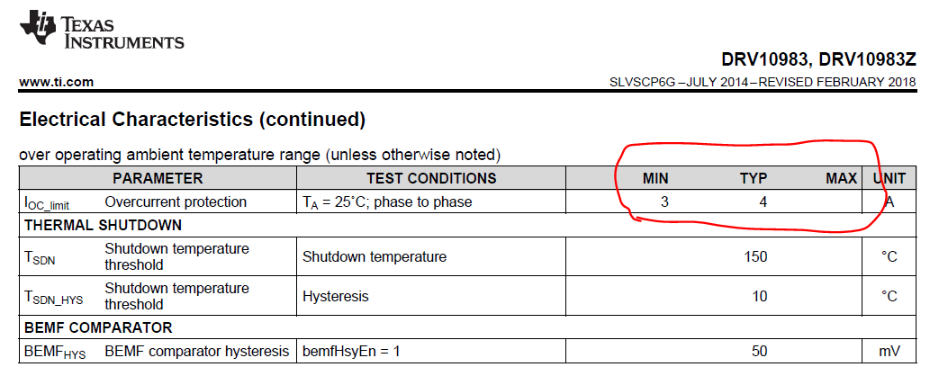

Our customer is using our DRV10983 and testing for the OC feature, but we checked the latest datasheet we only claimed the min and typ value without max value, can you help to check what's the maximum OC level for our device?

The Overcurrent protection protects the device from phase-to-phase short-circuit conditions. The overcurrent status bit (address 0x10 bit 5) is set when the phase to phase motor current exceeds the Overcurrent threshold limit (Ioc_limit). There is no maximum overcurrent threshold because the overcurrent status bit is set when the phase to phase current exceeds the minimum threshold.
