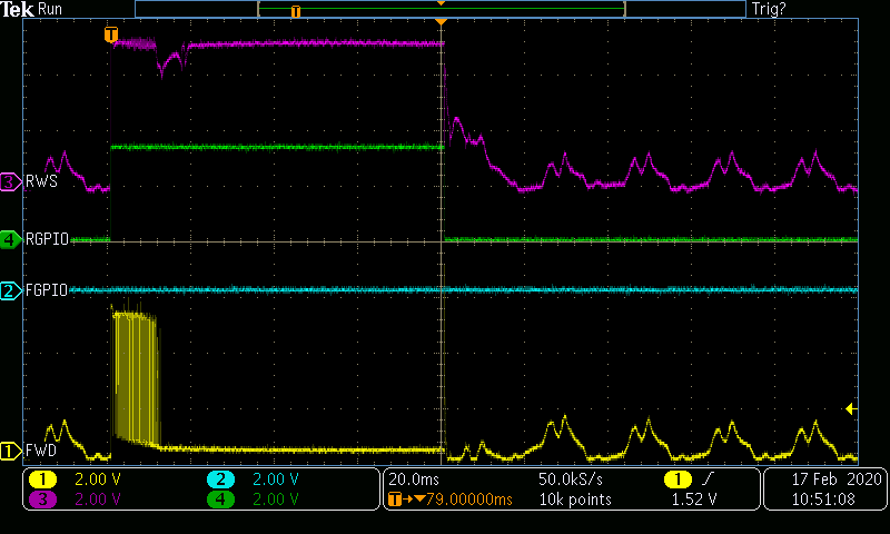

    For our application we need 80 msec enable pulse to move motor, where as we have seen some times motor stuck. Is This PWM will make any cause in output?
    Below are my circuit and waveform captured
    There is dip in IN1 after this 12 msec PWM. Please help

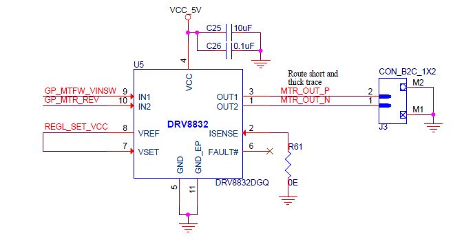

  • below is my circuit.
    Observed voltage dip at IN1 after 12 msec PWM and some times we have observed motor stuck. Whether this Output PWM will make any cause.
    Please help

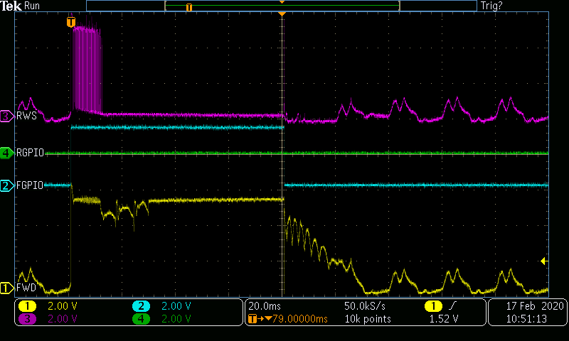

    Please find below for cross reference of names which we have used
    Scope: RWS: Pulse captured during motor reverse direction(J3.1)
    Schematics:GP_MTFW_VINSW: Forward GPIO(i have mentioned FGPIO in scope)

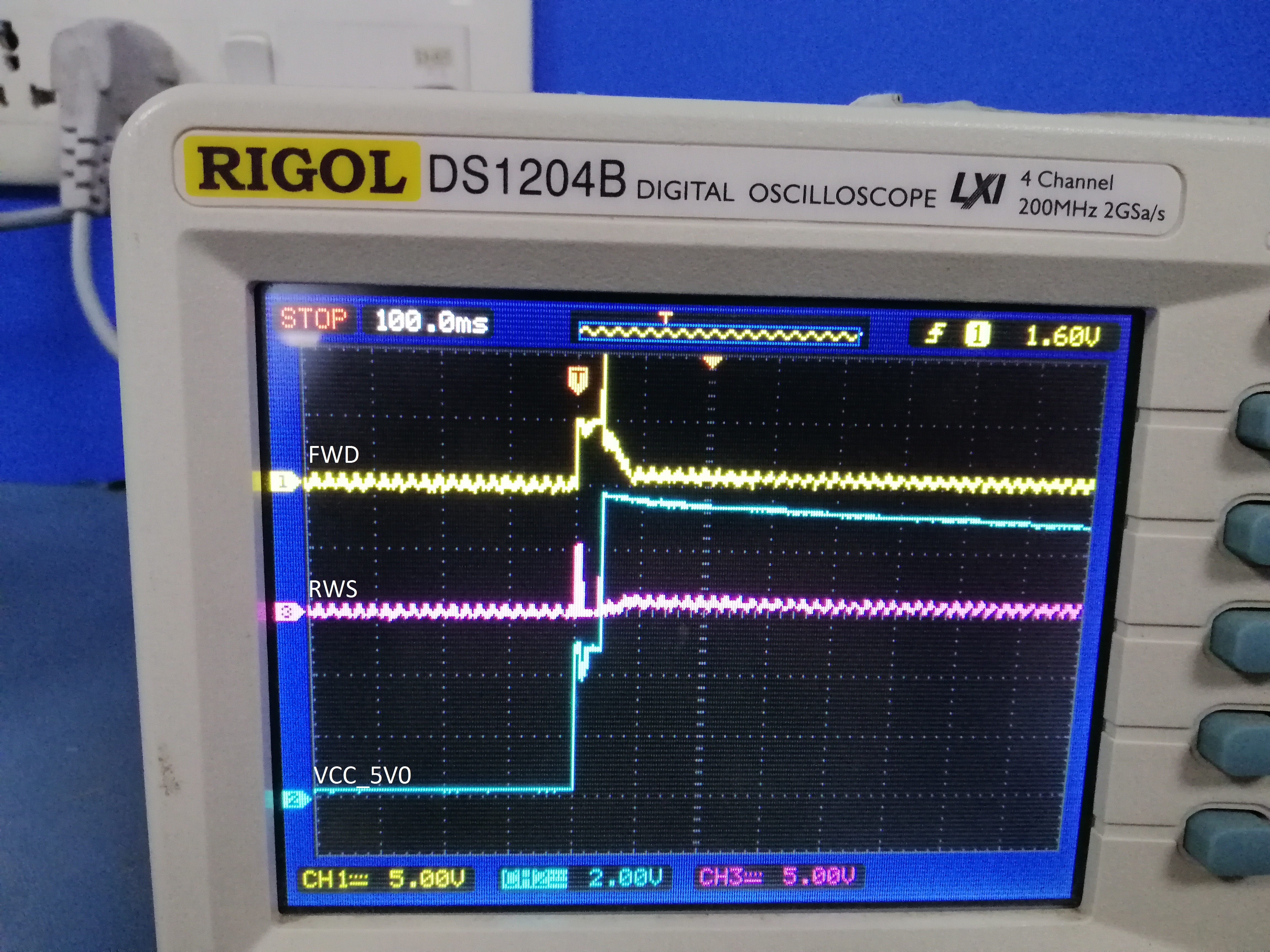

    Below is the waveform for VCC when there is voltage drop
    Please Note motor stuck is very rare and we wanted to understand reason.
    VCC_5V0 is generated from LDO(9V to 5V) where 9V is battery
  • Hi Manojkamar,
    Thank you for the additional information.
    There does not appear to be a reason for the motor to stick. Since it is rare, please try to determine if the motor position at start up is causing the sticking.
    It is also important to look at the waveforms (including FAULT#).
    If you have motor current information during the sticking event, please provide it.
    When the motor sticks, is a power cycle or sleep entry/exit required? This is an indication of too much current causing an overcurrent fault.
    Also, please note the droop on VCC is likely the cause of the droop on FWD.
    And the spike on VCC to 9V should be addressed. This is above the 7V abs max of the device. Additional bulk capacitance or a zener to GND may be required.

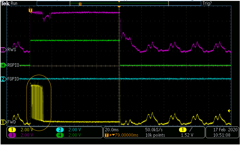

    We are using "DRV8832" for our application to drive 5V DC motor with 80 msec pulse. Where as while applying high on IN1 observed 12 msec PWM on IN2. Please let us know the reason why this is getting appeared.
    Please find below waveform, we are giving 80 msec pulse and after PWM only waveform is stable. Please help in this

  • We have used our own board. Following is my circuit.
    We have shorted Vref to Vset. As per above condition PWM should not appear on IN2. but here PWM is occurring. Please let us know the reason
  • Hi Manojkumar,
    If you are referring to the 12ms of PWM at the beginning (circled area below), this is how the device operates.
    From section 7.3.2 of the datasheet:
    When both inputs are low, the output drivers are disabled and the device is placed into a low-power sleep state. The current limit fault condition (if present) is also cleared. Note that when transitioning from either brake or sleep mode to forward or reverse, the voltage control PWM starts at zero duty cycle. The duty cycle slowly ramps up to the commanded voltage. This can take up to 12 ms to go from sleep to 100% duty cycle. Because of this, highspeed PWM signals cannot be applied to the IN1 and IN2 pins. To control motor speed, use the VSET pin as described below.
    If you do not want the PWM'ing at the beginning of the cycle, please consider using the DRV8837 as an alternative.
