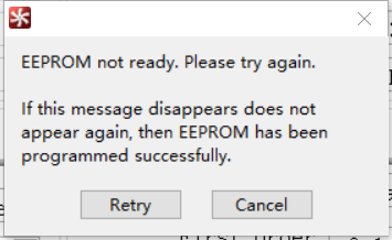

  • There is also a problem, after clicking "eeWrite" in the software interface, an error will be reported, and except that the set parameters have not changed after power off, the default selection after the restart is to control the speed through analog input? Is this normal?

    4. There is also a problem, after clicking "eeWrite" in the software interface, an error will be reported, and except that the set parameters have not changed after power off, the default selection after the restart is to control the speed through analog input? Is this normal?
    I'm not sure if you followed all the steps mentioned in the Datasheet to write data to EEPROM. Please check the datasheet Chapter 8.3.6 and let me know if you still have issues.

    about the 4th point above,i tested the board via PC "DRV109xx GUI",when i clicked the "eeWrite "button,an error box popped up,
    when i clicked “retry” button,this box disappeared.This problem ooccurs very time i write the eeprom.

    Qn: I tested the board via PC "DRV109xx GUI",when i clicked the "eeWrite "button,an error box popped up, when i clicked “retry” button,this box disappeared.This problem occurs very time i write the EEPROM.
    This is normal, when the user clicks the button, the GUI reads the EEPROM write enable bit (0x35[2]) and if it is 0, the window will flag it and write the bit for you. Clicking retry will check if the bit is enabled (and since it is) the EEPROM write process will begin. If the write was not successful or the bit wasn't set, then the error message would appear again. In your case, when you clicked "Retry" button, the box disappeared so your EEPROM write is successful.
