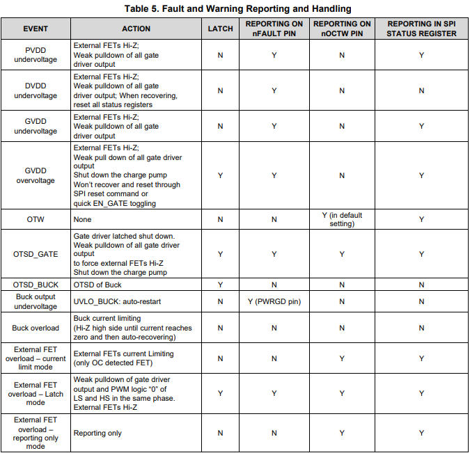

please explain me from where does the nfault pin in DRV8301 is activated??
does it takes signal from HV sense and LV sense only or from the INH_X and INX_L pins in the DRV8301 driver IC ????
Since the (nFAULT)  fault pin gives us all error signals. why there is a nOCTW pin in the IC ????
