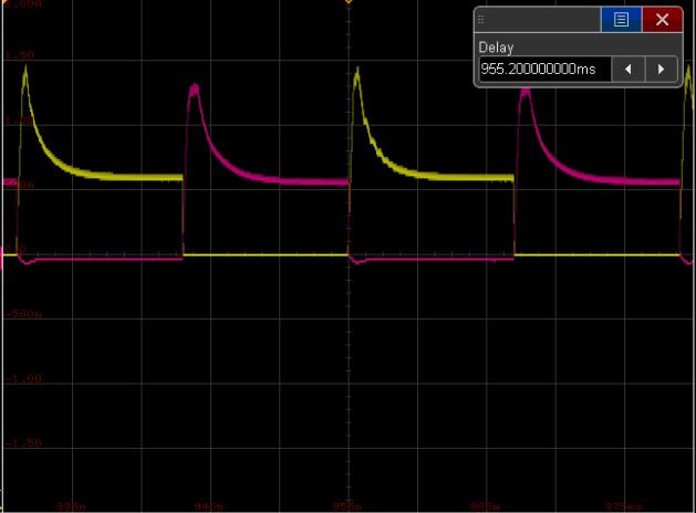

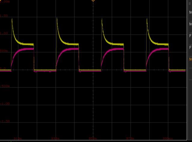

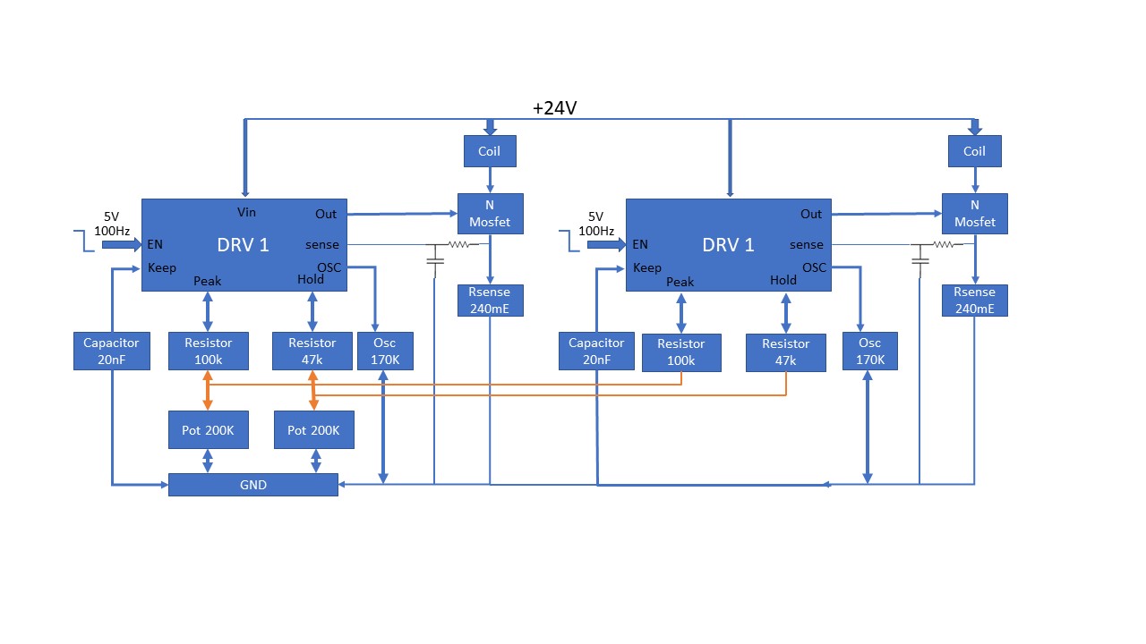

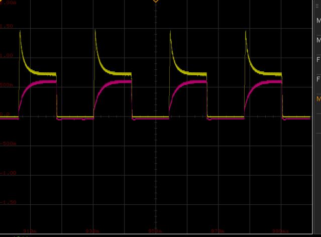

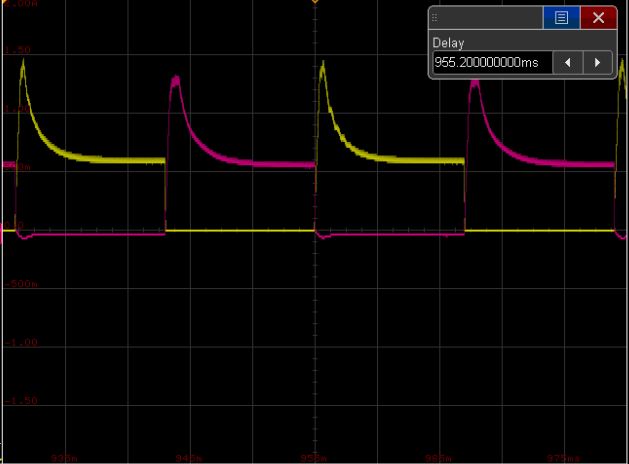

I have connected all the grounds together including both the DRV grounds, please refer to the attached document for connections and LTspice simulation for valve currents.
Coil1= On Coil2 = OFF
Fig 1: circuit block dia
Fig2: Coil switching for the alternative signal
Fig3: coil switching parallelly
Checked voltage drop at Peak and hold resistor during parallel switching and both are same

That's a current leakage to GND from Peak pin and Hold pin to GND. Did you tried without the common pot?
Replace the pot with a fixed resistor, one for each DRV110. The Peak and Hold threshold is set by the Peak_pin/Hold_pin to the GND_pin.

I want to control the current in both the coils by just using one Pot (2 pots, for peak and hold) and this set up is working fine when drv is getting triggered alternatively.
Is there any method to control peak and hold currents of multiple DRV's by using a single pot?

I don't see any issue using one pot for both, the singe fix resistor to GND pin suggestion is for debugging.
What I don't understand is the slow current rise time, it looks like low coil voltage
