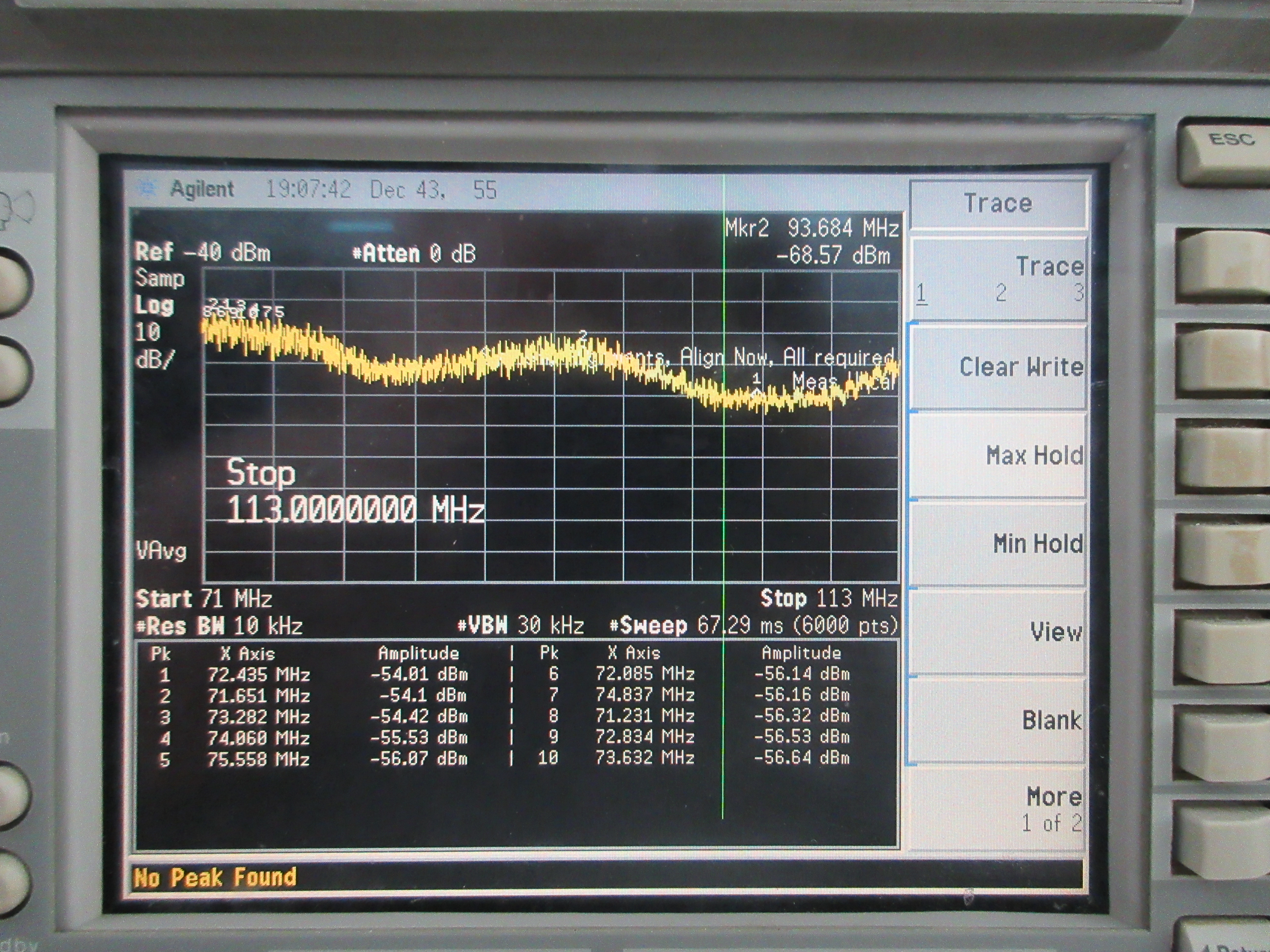

  • Hi Luis
    There are two pictures of resut of the spectrum analyzer when our team do the noise test.
    The picture 1 was taken when all the devices got ready to power on except for the enable port of haptic driver IC was low, which is meaning the driver IC was inactive.
    As you see, the floor of noise seems okay and there is almost not any obvious spike.
    Then, we pull up the enable port the driver IC.
    And the noise had get so seriously as the picture2
    Picture 1
    Picture 2
    Above all, our team thought the resouce of the noise may be the driver IC.
    By the way,
    12V battery that is usually used for autmotive was used for haptic IC driver, and we do the conductive noise test on the wire between battery and haptic IC.
    A 5V regulator IC provides 5V to pull up enable port to make the IC active.
    Could you give us some suggestions so that we can overcome this issue
    Yun Lin

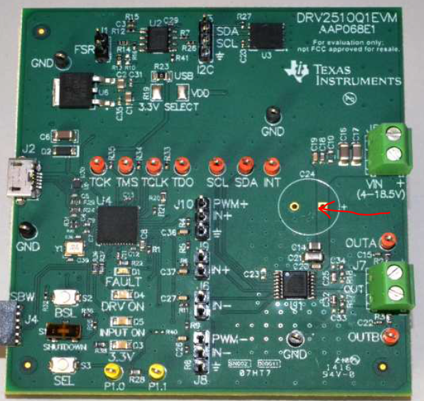

  • Hi, Luis,
    Our team have do some struggle wished to resolve this issue of EMI.
    • We changed the number of frequency inside the driver IC of DRV2511 and DRV2510,
    Unfortunately, there is almostly not any obvious difference of noise level.
    • We added a (unmounted C24 as below PCB) Al-condenser which has comparative high capacitence as 220u,
    however it seems that the added condenser can not help to lower the noise level
    •  We cutted off the power line at the place of the red arrow as below, and insert a inductor of (range of 100u 47u 16u 1.0u )
    to bridge the cutted land pattern of power line to build a pi-typed low pass filter. We hope that will work well to remove the noise,
    in the end, there was no improvement of this issue either.

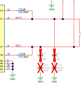

    • We also added the unmounted resistors(R17, R18) and condensers(C33, C34) to output side, but these components seems no helpful.
    Above all, oure team have not found a certain method to take off the noise issue.

    And do you consider whether the recommend optional EMI filter of output path can help us.
    If we have to introduce this filter components to our electronic circuit, how can we select the components of C and L,
    I mean how to decide the ω0, If it is 400K(or 500K) multiple 2times π
    Best regards
    Yun Lin

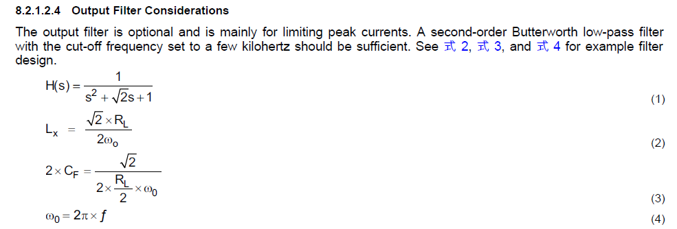

  • Hi, Yun,
    Could you try with an output filter with 20KHz or 30KHz as Wo value, please? This should be enough to reduce the switching frequency noise.
    Luis Fernando Rodríguez S.
  • Hi Luis,
    Thank you for your mention about the output filter,
    Our teem will try that, and feedback the result to you.
    By the way, can we know the reason why the frequency for the caculation is 20~30KHz instead of 400KHz~1.2MHz.
    Yun Lin
  • Hi, Yun,
    The 400KHz is the switching frequency of the device, but the useful signal is not in this frequency range. The filter must be adapted depending of your input signal. What is the input signal frequency range that you will use in your design?
