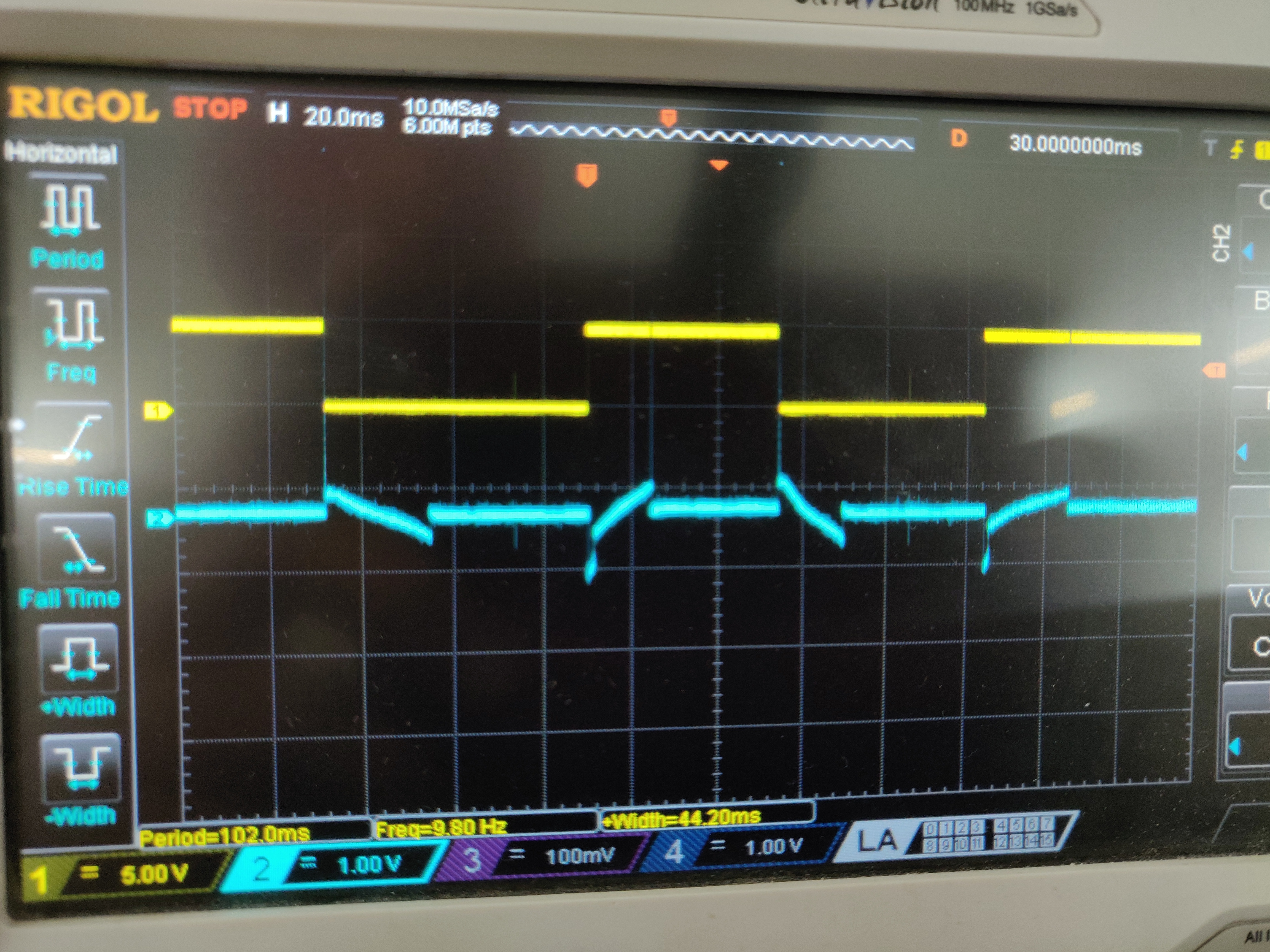

      As yesterday i on DSO i find that the first half of my Trapazodial is missing. I am attaching is the screenshot .Please check and let me know  The above image is of Mosfet Gate Signal taken when the motor of  4000 RPM connected. That should be clear Trapazodial.

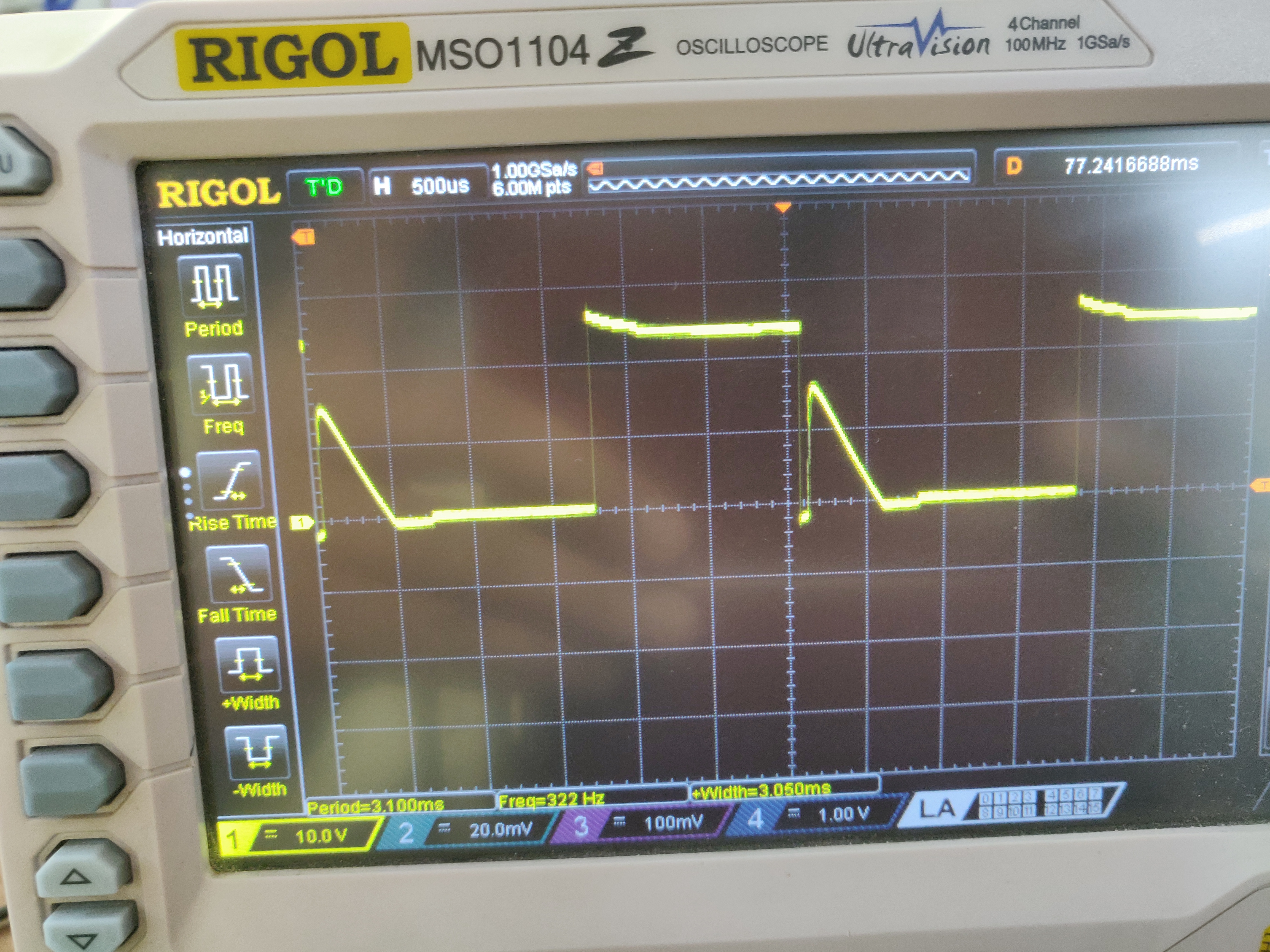

    the above image is when we run the motor at 50% of speed.

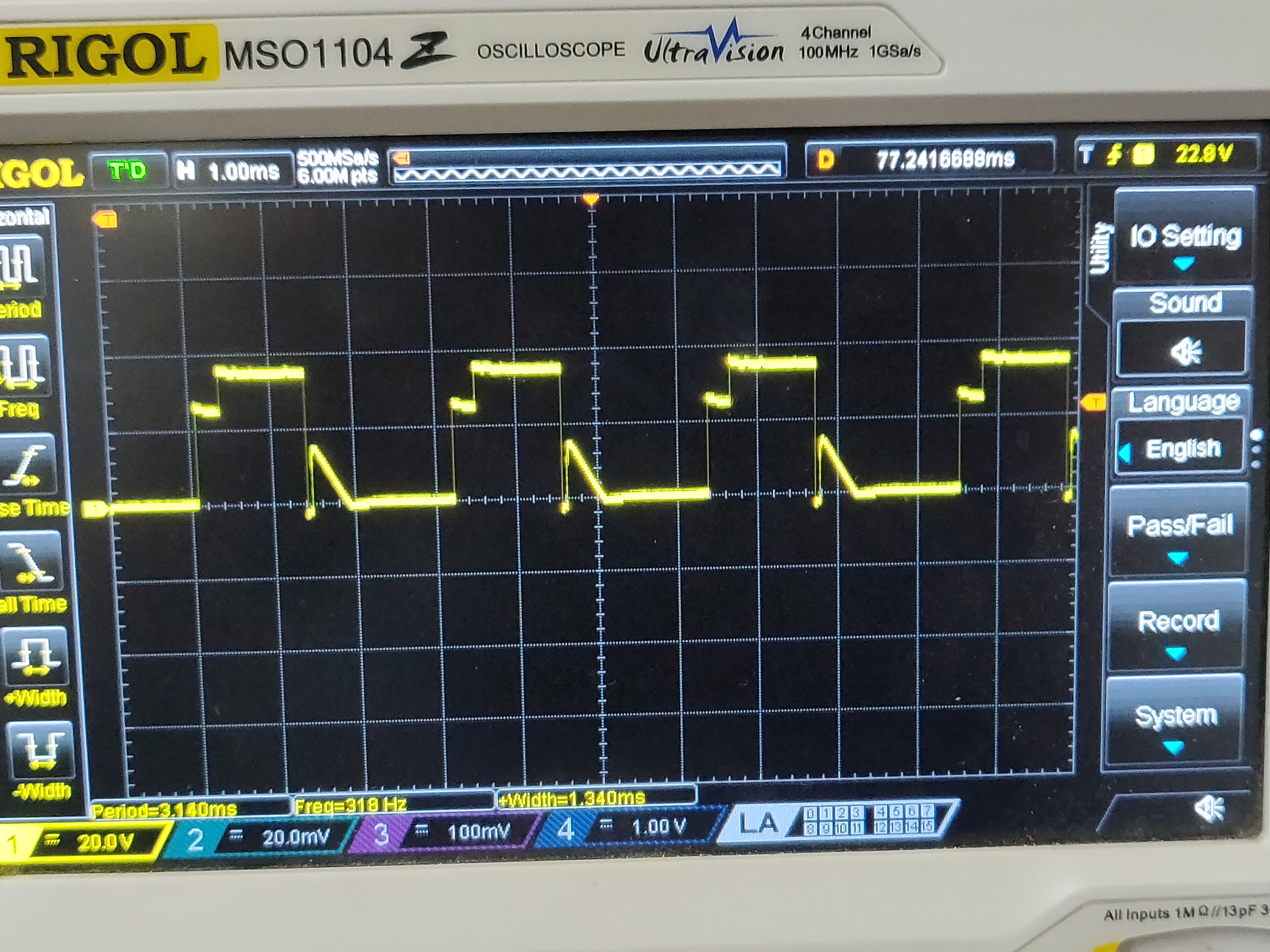

    this pic is of Phase voltage when we run the motor at full speed.
    so please let me know. why its noot give a clear trapezoidal wave.

  • Sukhpal,
    If your BEMF waveform does not look correct it is likely that your HALL sensor inputs are not synced with your Motor phase outputs.
    Please make sure that your motor phase A is connected to pin input A on the board and hall input A is connected to hall input A. Same check for B and C.
    You can check this FAQ as well: https://e2e.ti.com/support/motor-drivers/f/38/t/845535

  • Sukhpal,
    You may have some issue with your commutation code or sequence.
    Do you have an EVM you can try with your motor?
    -Adam

  • Sukhpal,
    The DRV does support high speed motors. I would check that your power supply can provide the immediate switching current and check that your hall sensors are aligned to the phases. Please also check that the phases are connected in sequential order as A-->B-->C.
