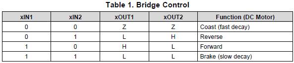

My customer is interested in the DRV8848 for stepper motor.
Is it possible to set Decay(Coast, Brake) on the DRV8848EVM via GUI?

Hi Yamaguchi-san,
The DRV8848 can regulate current in mixed decay mode (25% fast / 75% slow) using VREF and Rsense.
If you want to use Brake or Coast to regulate the current, external circuitry may be needed to measure the current and take action.
