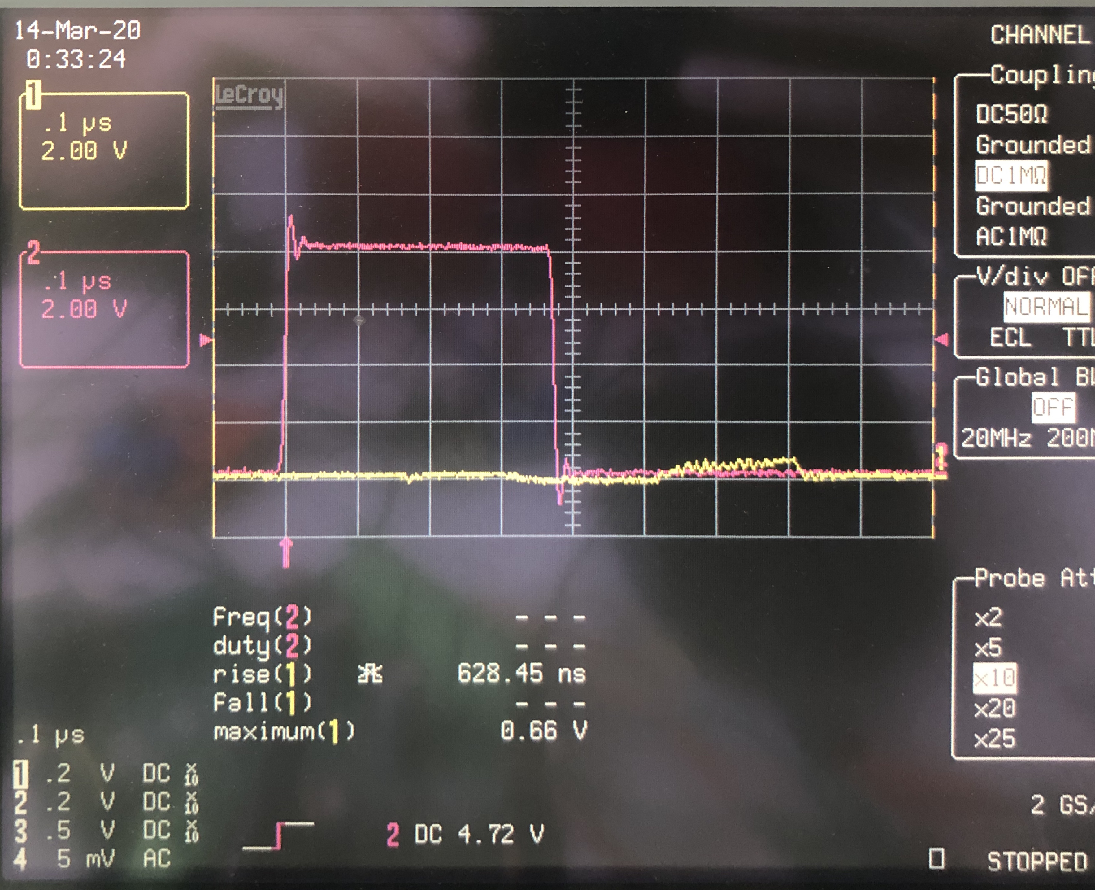

Hi Danilo,
I tested the minimum PWM duty cycle of DRV8306 using the DRV8306EVM and a PWM frequency of 20kHz and VM = 12V.
I lowered the PWM duty cycle by increments of 0.01% from 1% until I did not see any response on the GHA pin.
With a minimum duty cycle of 0.75% (~380ns ON time), I was able to get a response on output SHA. I attached the oscilloscope screenshot below showing a response of SHA (CH1) with PWM (CH2).
