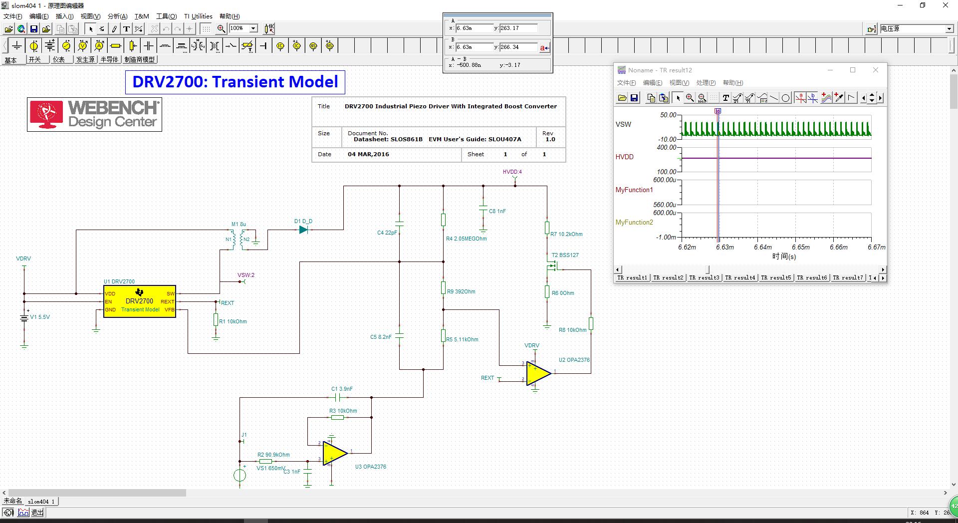

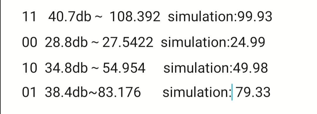

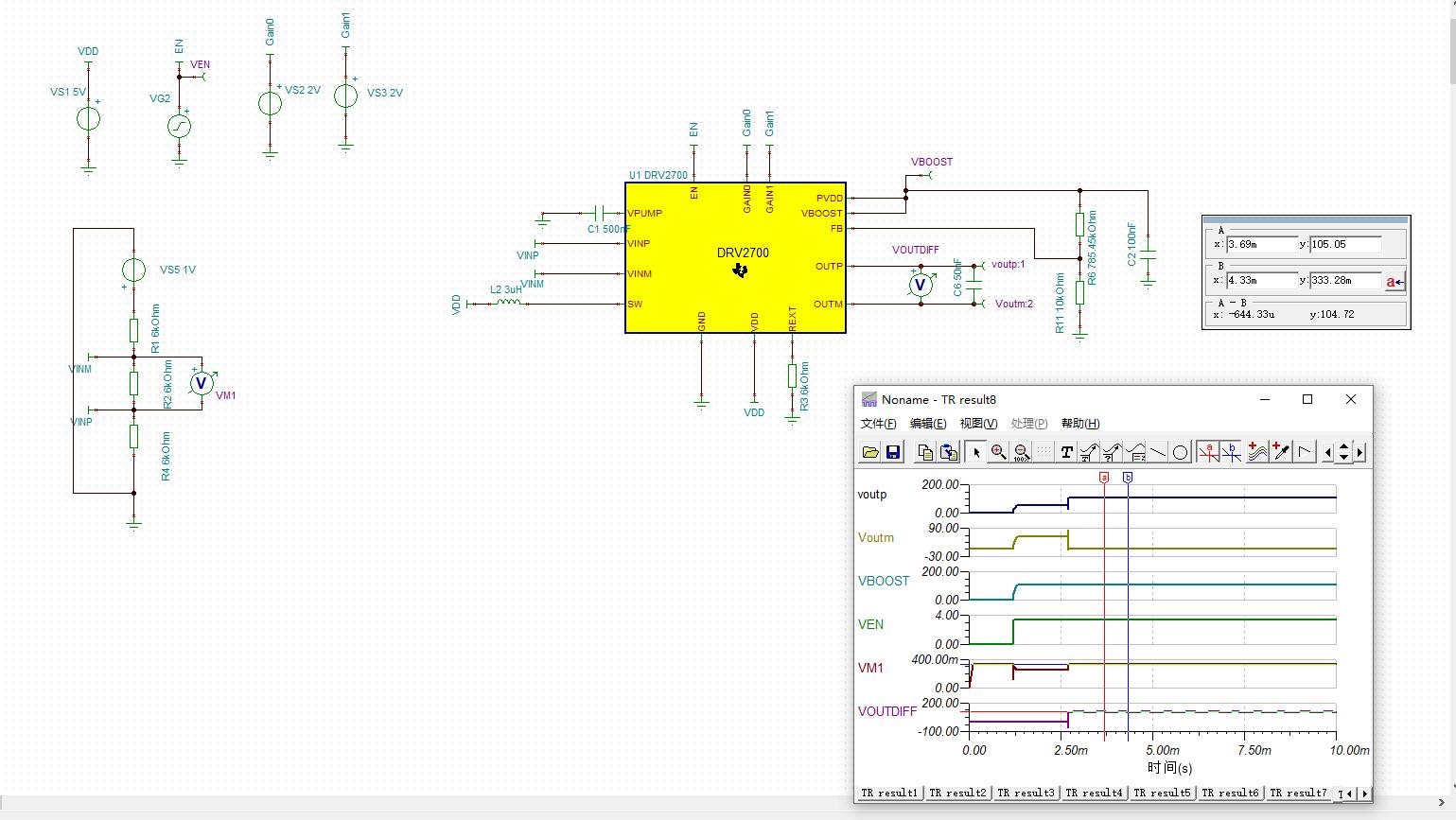

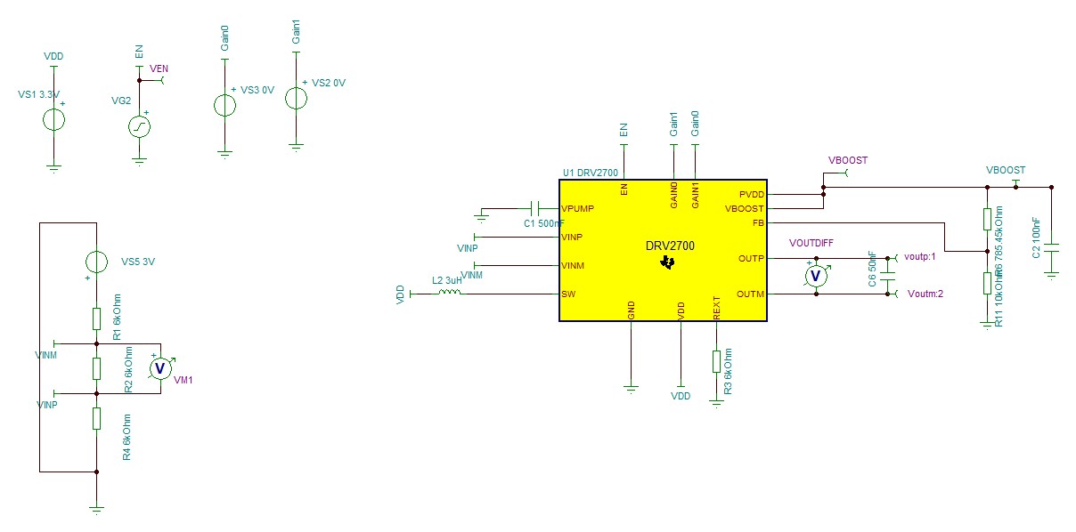

I am going to do a piezoelectric motor drive, according to the drv2700 instructions to connect the circuit to select parameters in the Tina .But the simulation of the magnification results and specifications are different. I don't know if it's my circuit parameter error or would have been like this. If I set Gain 11 is 40.7 db the conversion multiple is 108 times. But I only simulated 99.93. And I set to 00,01,10 are different degrees of deviation from the specification. Below is my circuit diagram, and the magnification of the simulation test deviates from the actual multiple. Is it my circuit problem? Hope answers.
