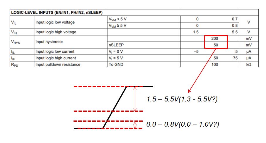

Hello team,
I would like to understand about Input Logic hysteresis on DRV8874.
Attached is the image of my understanding of it so far.
Logic Low: 0 - 0.7Vor0.8V / Logic High: 1.5 - 5.5V
Hysteresis: 200mV means
Logic Low:0 - (0.7or0.8V+/-0.2V) / Logic High: 1.5 +/-0.2V - 5.5 +/-0.2V ?
Please tell me how to consider the input level voltage.

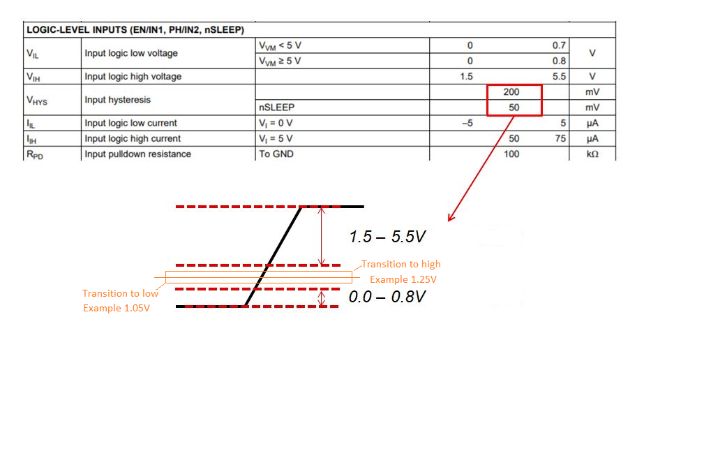

  • Hi Kitajima-san,
    Hysteresis is added to prevent input switching due to noise.
    Once the input has switched from high to low or low to high, 200mV is typically needed to switch the input back to the prior value.
    The VIL and VIH specifications of 0.7/0.8V and 1.5V do not change.
    As an example, please see the updated diagram below.
    The typical switching point for the EN/IN1 and PH/IN2 inputs is 1.25V for a low to high transition. Once the input reaches 1.25V, it must fall to 1.05V to be recognized as a low. The difference between the low to high transition value and the high to low transition value is the hysteresis (200mV).
