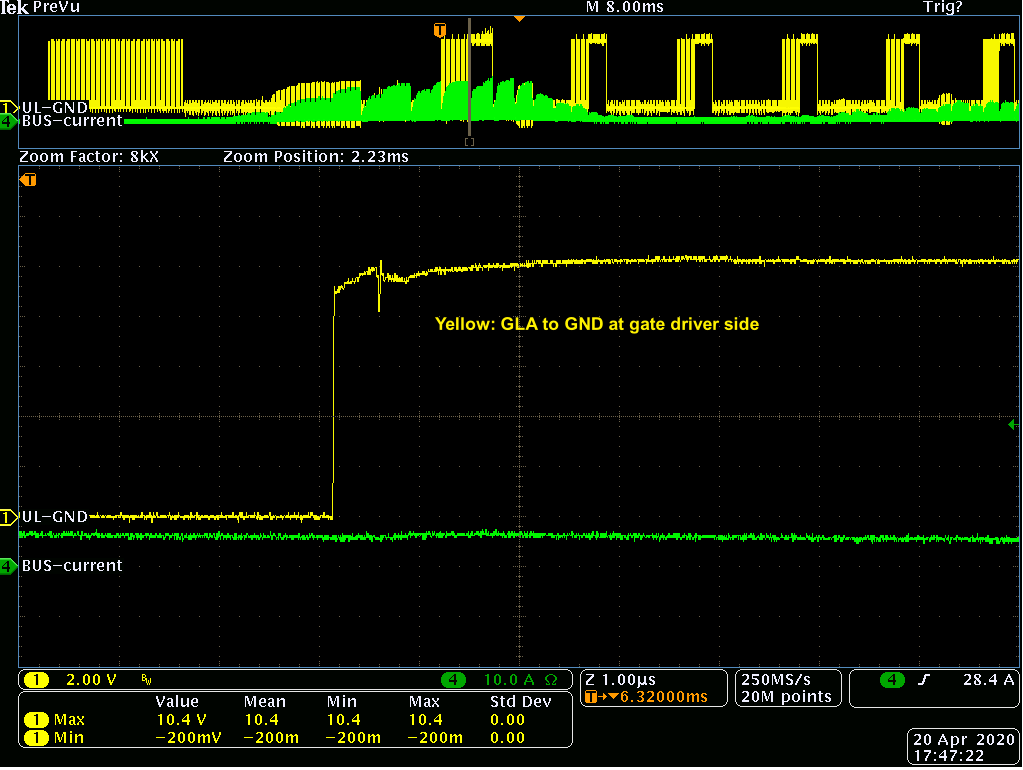

Hi Ti team,
We are using DRV8305 gate driver to finish a BLDC driver. We found really heavy oscillation on the MOSFET gate. we are using MOSFET: IPB042N10N3, no gate resistor, driving current set 100mA ON 200mA OFF, shown in below pictrue. You could see the negative spike is around -9.2V. I have questions below:
1. I only found this oscillation when bus current is big(like start up or with a heavy load), when the motor in free speed run(current around 3A), we did not see that. why? what caused the oscillation?
2. the Negative spike is -9.2V, duration is below 34ns, will it be a risk to damage the DRV?
3. Any suggestion to improve the oscillation? Add gs capacitor?
Thanks!
