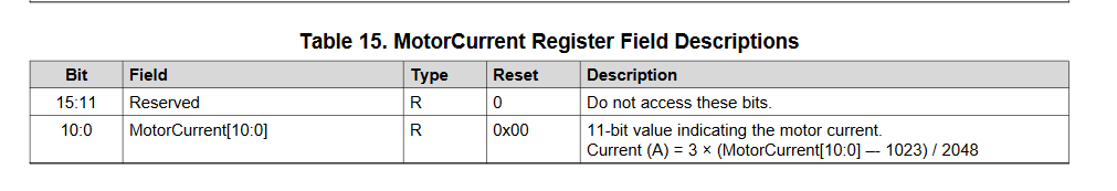

0...2047=-1,5A..+1,5A? I can not interpret the -1023 meaningfully.
The measuring range should go from 0..3A?
Thanks for posting your question in E2E. The current measuring range is from 0 A to 6 A (rms).
https://e2e.ti.com/support/motor-drivers/f/38/p/776339/2878404#2878404
Here is the equation for converting the register value into actual current.
