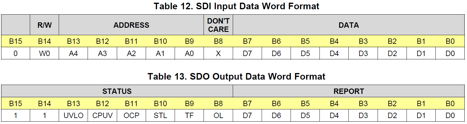

my customer use DRV8889-Q1, and have a question on coding.
  • do they need to shift left 9bits(SPI_ADDRESS_POS)? For example, the register address 0x07=(00000111), so they need to send (1000 1110 0000 0000)?
  • the right format is |R/W|A6|A5|A4|A3|A2|A1|A0| D7|D6|D5|D4|D3|D2|D1|D0| OR |R/W|A4|A3|A2|A1|A0|*|*| D7|D6|D5|D4|D3|D2|D1|D0|?
that is to say how about A6|A5 coding?
  • please help check the below code comments are right or not:
 /* Register format |R/W|A4|A3|A2|A1|A0|*|*| D7|D6|D5|D4|D3|D2|D1|D0|
* Ax is address bit, Dx is data bits and R/W is read write bit.
* For read R/W bit should be 1 */

  • Kelly,
    In the datasheet, Table 12 gives the command detail.
