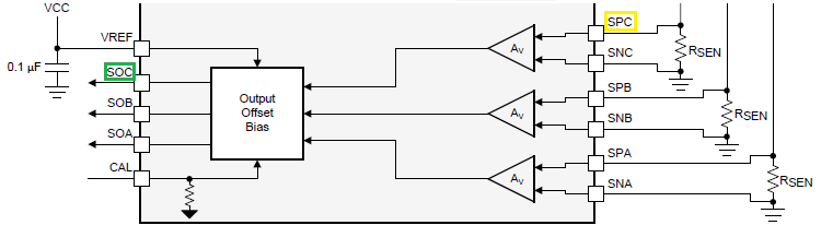

I have problem with internal Current sense amplifiers.
You can see pictures from Scope. There are input SPC and output SOC signals measured to SNC (GND).
After power up, everything is working. Pic 1: SPC = 0V, SOC = 1.2V

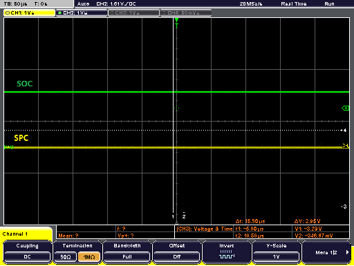

After Reset ( 1s low pulse on ENABLE pin) is the value of the SOC pushed higher. Pic 2: SPC = 0V, SOC = 2.1V

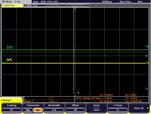

On Pic 3, it is closer look at the SOC value change.
When is the level push higher, the value is incorrect, and the driver doesn't work.

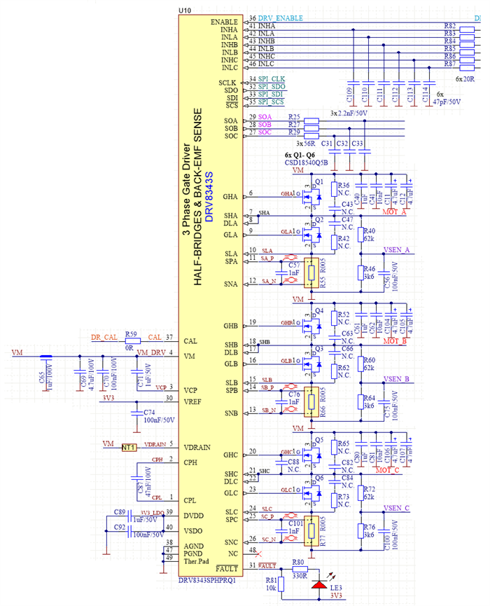

  • Hello Adam,
    Thank for your response. I just realize that I fill title wrong. It should be DRV8343SPHPRQ1.
    But the schematic is almost the same like EVM.
    VREF is power by 3V3 LDO.
    Best regards PJ

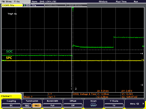

  • Hi Aaron,
    I attached scope pictures, there are: Enable, Vref, SOA, SPA signals, and time after SOA spike above 1/2 Vref (purple highlight).
    Vref = 3.32V
    SOA = 1,56V (before reset)
    SPA = 0V
    After Reset (Enable push to 0V) there is short voltage drop (grey highlight).
    All test are made with motor connected, before enabling PWM signals.
    Regards PJ

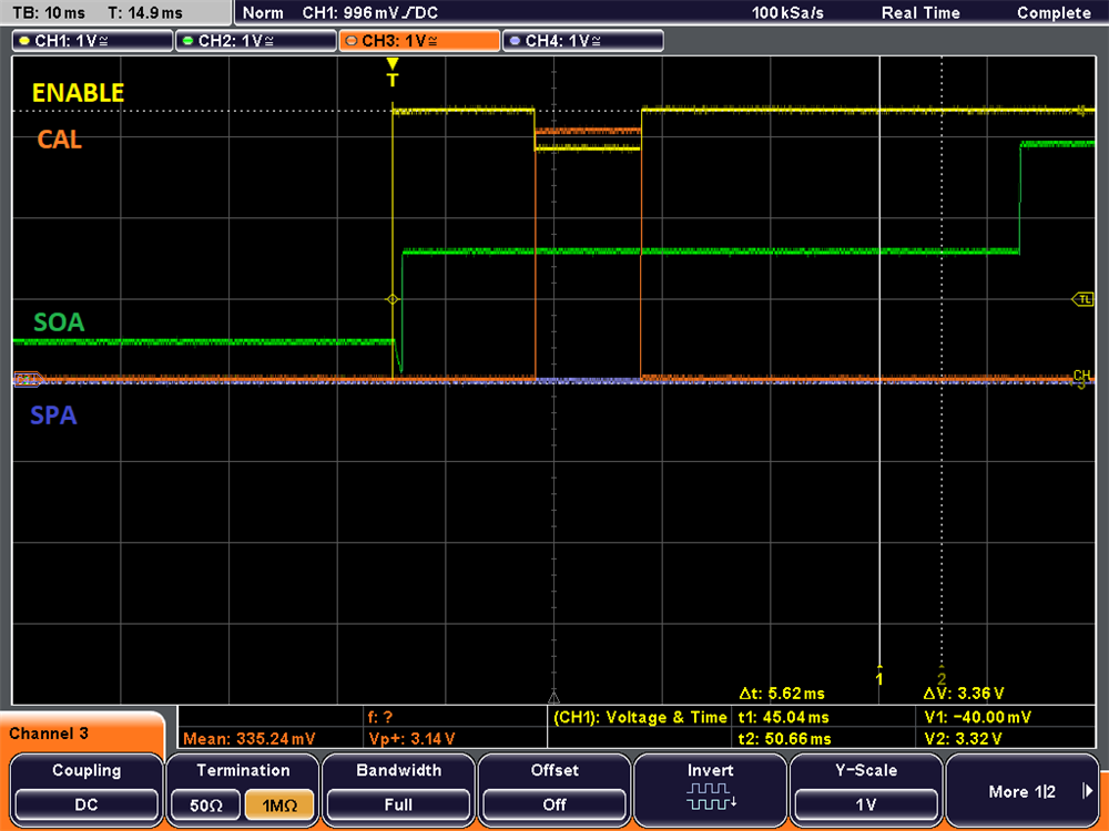

    I have another Scope picture. It is very strange that Enable drops exactly the same time when power up auto calibration started.

  • Hi PJ,
    From the image above, I am looking at a few areas of concern:
    1) CAL pin not reaching 3.3V when logic high & ENABLE dropping ~0.5V (might be a brownout condition with the 3.3V source)
    2) SOA reaching near ~3V, (i.e. current would be close to zero if in unidirectional mode or large amount of current is going through shunt resistor to SHx)
    Could I get more information on what you're using for the 3.3V regulator, and could you share that circuit?
    I am also curious to see what happens if CAL is not asserted - does SOA behavior still occur?
    Finally, could you capture an SDO signal just to make sure SPI is working?
  • Hello Aaron,
    After reset, before SW fully starts, GPIO pins are pulled high (not high Z), and we had to pull them down. It caused the problem on Enable and CAL pins.
    We don't need manual calibration, so we disconnected this pin. For Enable pin we used 2k2 pull-down resistor.
    Also we sent SPI communication to much early after reset.
    Now we have all the signals in their correct state and everything works fine.
    Best Regards PJ
