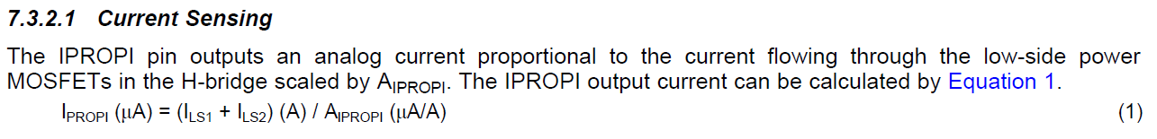

We found that the motor driver provides a current in both directions(limit of -7.5mA to +7.5mA) depending on the rotation direction of the motor.
So does that mean the output on the pin "IPROPI" will be a negative value when the motor reverse?
if we just create the circuit according to the reference design on datasheet as below, when the motor run in the reverse direction, if there is a negative out from the pin"IPROPI"?
Should we need to add additional component on the pin "IPROPI" when the motor run in the reverse direction?
