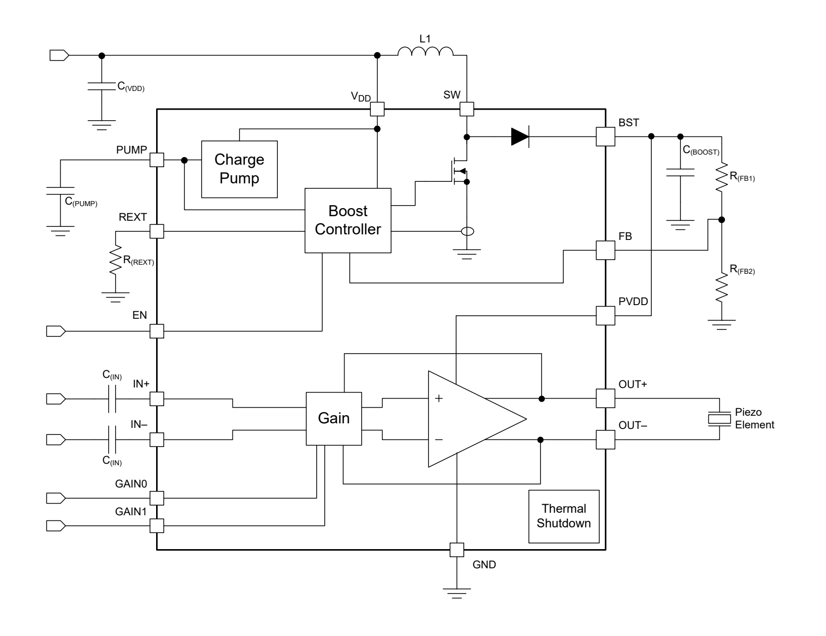

I am trying to use DRV2700 as piezo driver. I built a breadboard-based prototype based on the following schematic (which is from the DRV2700 datasheet). Power input was 5V. The signal (sine wave) inputs (IN+/IN-) were from a signal generator. EN/GAIN0/GAIN1 pins were set HIGH. The measured BST voltage is as expected - 80V. However, the output signal (OUT+/OUT-) was not sine wave (cut off significantly), and it wasn't amplified either... the output signal is also shown below.
I tried 3 DRV2700 chips and they all show the same characteristics. Can anyone help me with this?

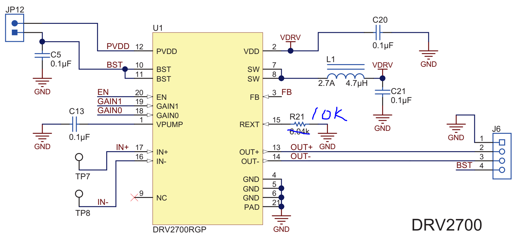

  • Thanks Luis. Below schematic shows the external component values I used for DRV2700 prototype, basically, I copied it from the DRV2700EMV evaluation board except the REXT resistor (I used 10k instead of 6.04k).
    In terms of sinewave, I used single ended signal, IN- directly connects to GND, IN+ connects to sine signal with 0V off-set voltage. JUST FYI, I also tried output differential (PWM through a external low-pass filter) signal through microcontroller but it show the same issue (no amplification).

    Could you also try with a lower resistor (similar to the one used in the EVM)? Usually the output level can be also limited if the resistor is high.
    Do you have details about the FB connection?

    I changed the REXT resistor to 6.4k and probed the output signal when there is no input signals. The VBST is 84V while the VOUT+/VOUT- is around 16V with a lot noise. Please see the picture below, the blue signal is one of the VOUT.
    The FB voltage divider is 10k pull-up and 820ohm pull down.

    Regarding the analog inputs IN- and IN+, do you have AC-coupling capacitors connected? The analog inputs require of input capacitors in order to correctly reach the common-mode level. I noticed that you mentioned that IN- is directly connected to GND, but this connection is not suggested or the device could have unexpected results.
    Could you try adding 0.1uF capacitors at the input, please? Please let me know how it results.
