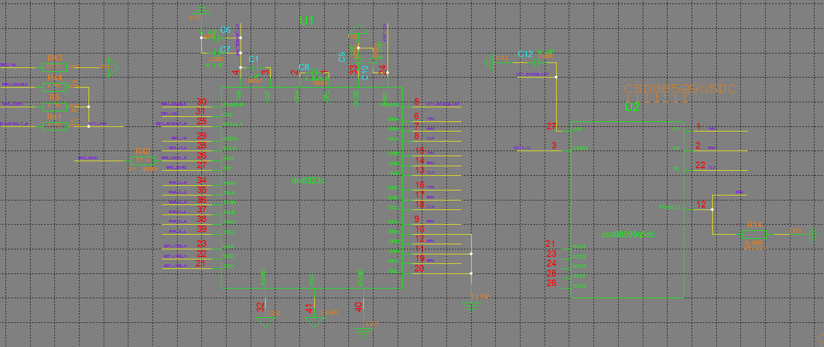

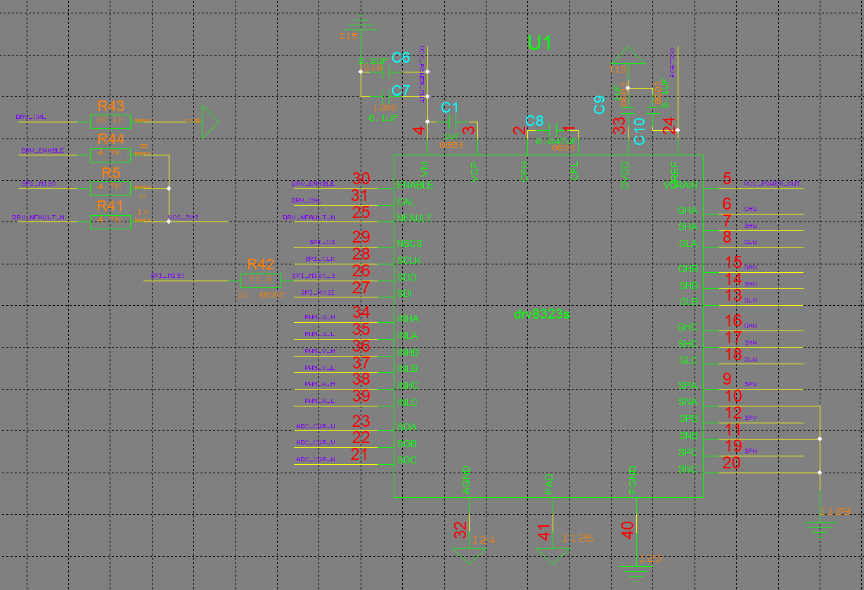

    Could you share your schematic for us to review?
    -Adam
  • Hello Adam:
           I'm very  glad to receive you reply.
    The schematic is shown as follow:
    These two questions troubled me a lot:
    1、Why does PWMwave of GHx out from drv8323s have a platform instead of dropping to zero directly when high-side Mosfet turns off.  It's very dangerous   if  the high-side Mosfet and the low-side Mosfet conducted together in this case.
    2、The currents from SOx of drv8323s are almost unchanged no matter the motor is reset or working in open loop. I want to know why the currents are unchanged. Whether the configurations of registers  are incorrect ? (The SDI input data words in regesters are 0x1000(address:0x02),0x1B88(address:0x03), 0x2488(address:0x04),0x2B7E(address:0x05),0x3243(address:0x06))
    Thank you very much .I'm waiting for your reply.

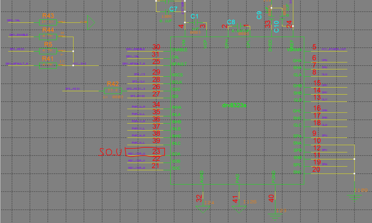

    Could you show us where SO_U is measured in the circuit?

  • Dear Adam:
           A good news is that we have solved the problem and the offset is working. Thank you very much for your help.
          SO_U in the circuit is as follow, the problem is caused by pin configuration in software.
    Yours sincerely
