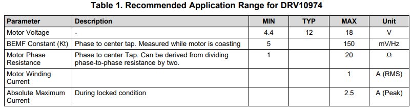

    Thanks for posting your question in MD forum. Looks like the device is stuck in open loop and unable to transition to closed-loop. IS the customer using DRV10974EVM or a custom board? First thing I would like to check is to make sure the motor that is used falls within the recommended application range shown in below table :
    Next, I would recommend to check the tuning guide which explains two ways to tune the motor (Quick tuning and comprehensive tuning). The goal of quick tuning is to get the motor running quickly by inferring usable resistor values for the current (CS pin), lead time (ADV pin), and acceleration profile (RMP pin). Please check the comprehensive tuning section if the motor performance is not satisfactory after following the recommendations in Quick tuning section.
