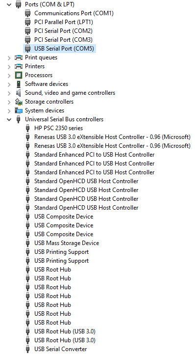

I don't see any USB devices in device manager that show as problems.  There is a USB serial port (COM5) present, but no others.

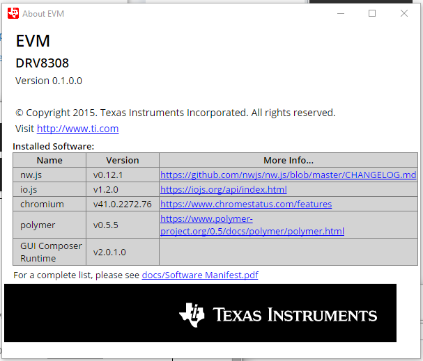

    Which exact version of the GUI and installer are you using?
    If you unplug and replug the EVM USB cable with the board powered, which device comes and goes on the device manager screen?
    -Adam
  • USB port COM5 comes and goes with the EVM.
    GUIComposerApp-0.1.0.setup-win_2.0.4.exe
    gcruntime-2.0.0-windows-installer.exe
