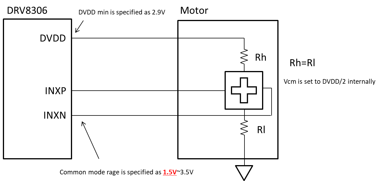

On the datasheet, the high and low thresholds for Hall comparator are very unclear…

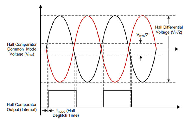

I understand that as following though, could you double check if my understanding is correct or not?
VIT+ : No spec in datasheet, estimated Vhys/2 from following figure?
VIT- : No spec in datasheet, estimated ‐Vhys/2 from following figure?
Delta threshold : VIT+ - VIT- = Vhys
I can understand this comparator has much tolerant against noise but actual positive and negative threshold is unclear on the datasheet description.
Could you tell me the reason why VIT are not specified on the datasheet also? I need to explain that to my customer.
