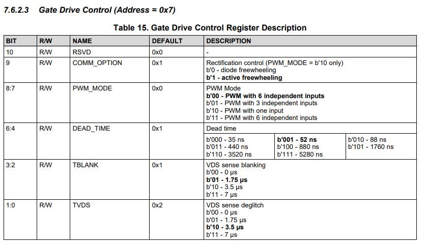

I initially had an issue with PVDD undervoltage flag warning and I set it disabled.
Now I had no output on VSENSE without any faults.

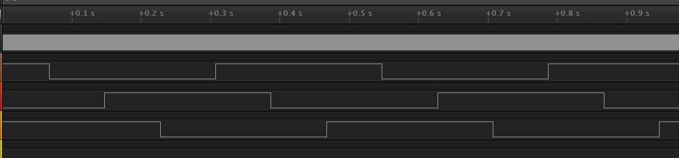

I set Walk up High, Gate EN high and start generate 1 pwm and 3 step signals as below.
1. PWM 2.A 2.B 3.C
Apart from 0x07 register which is about IC control and  PVDD undervoltage enable, I haven't changed any registers.
I was a bit confused with PWM mode. I am using 1 pwm with 3 step signals. It must be either b'01(PWM with 3 independent inputs) or b'10 (PWM with one input).
I tried both and neither of them generate the output of the FETs.
Please let me know the correct mode and what possible issues for the operation.
