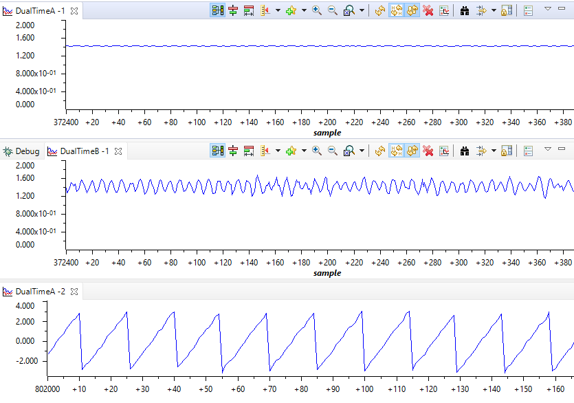

I am using the datalog to capture Idq_ref_A.value[1] (Iq_ref) and Idq_in_A.value[1] (Iq_in).  And am graphing both.
OK.  So everything works fine up to 400Hz on the speed reference.  And by fine I mean both Iq_ref and Iq_in are both stable and Iq_in tracks to Iq_ref. But once I get above some threshold value of speed reference (450Hz in this case), Iq_ref goes to ~ 2.7A and seems stable while Iq_in starts oscillating from just under 0 A to almost 5A. See screen shot below where Iq_ref is on DualTimeA and Iq_in is on DualTimeB.

  • Sorry - forgot the screen shot.
    This first one show Iq_ref, Iq_in, and estOutputData.angle_rad when the blower has reference speed setting of 300Hz.

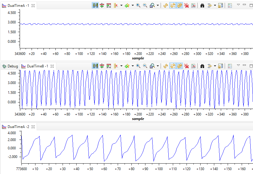

    This next screen shot  shows the same except the speed reference is 400Hz.
    And finally, this last shot shows the same 3 waveforms when the commanded speed is 500Hz.
    Any thoughts on why Iq_in went out of control?
    The angle seems severely distorted when Iq_in goes out of control.  Interestingly, the shift from stable to unstable seems to be very abrupt.  In this case, Iq_in is stable at 465 Hz and unstable at 475Hz.   Any reason why the angle is getting distorted so bad?
