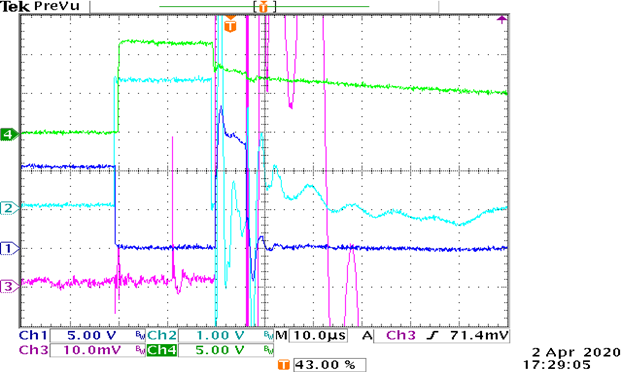

Because I found that when using two phases to control a single coil, the MOS is often damaged,and I caught some abnormal waveforms with an oscilloscope
It can be seen that when the low side MOS is opened, the  voltage of high side GS rises, causing a large current
The waveform and my circuit are as follows
CH1   The  High-Side gate driver of Q15(GS_H with Differential probe)
CH2 The  Low-Side gate driver of Q15(GS_L)
CH3 Coil current
CH4 Sampling resistor voltage
Can you help analyze the reason?

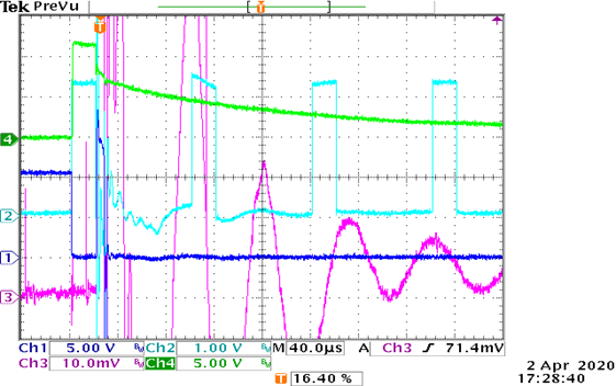

  • Hi Adam:
    Thanks for your reply.
    I can show you another waveform including the Turn On of the low side FET, It needs to be explained that the waveform is normally normal,
    it took several days of work to catch an abnormal waveform,Now I only have these two abnormal waveforms
    CH1   Q15 Vgs on low side FET
    CH2 DRV8323 INHB
    CH3 Sampling resistor voltage
    CH4 Q15 Vgs on high side FET
    CH1 and CH4 both use the Differential probe

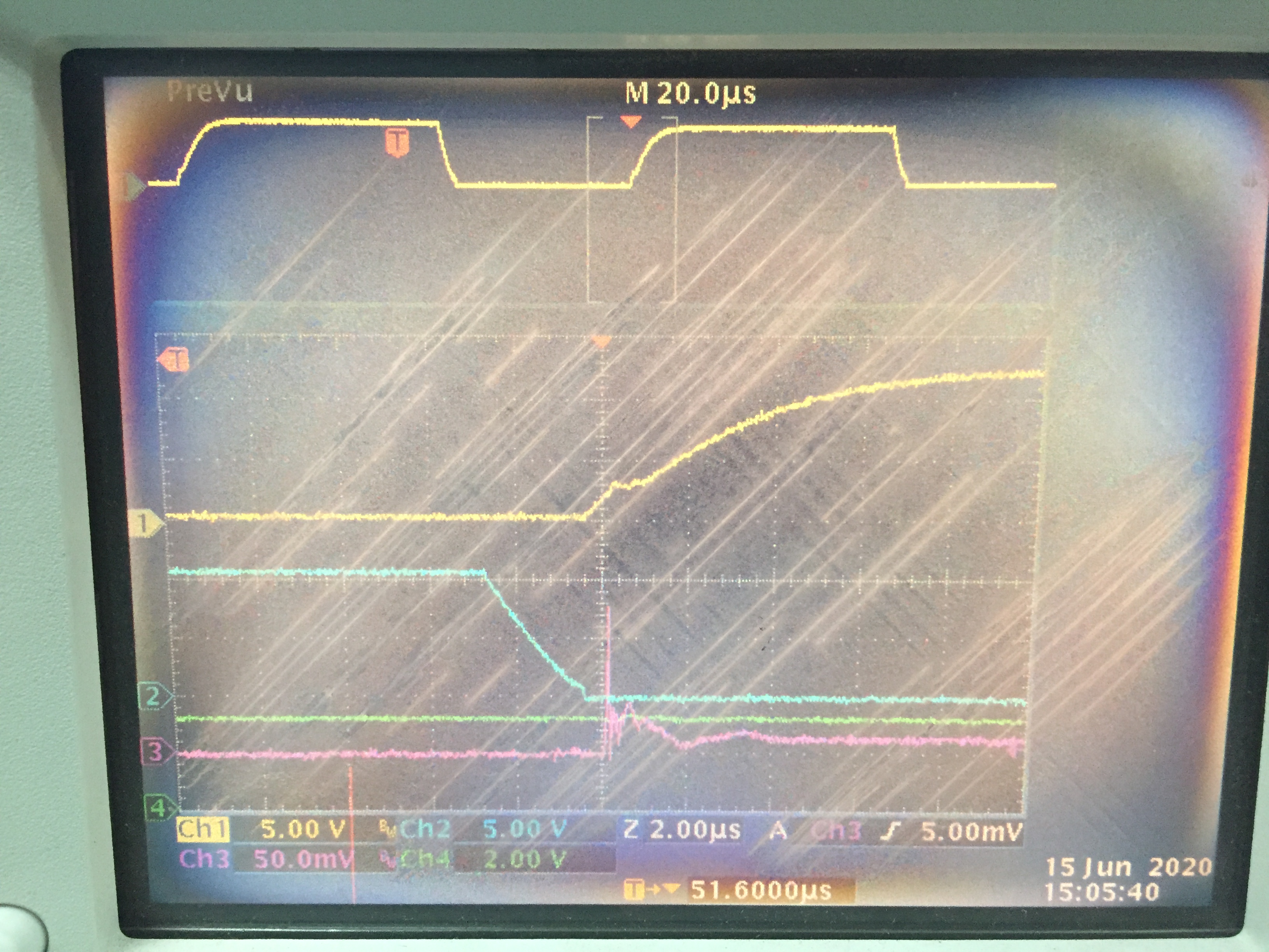

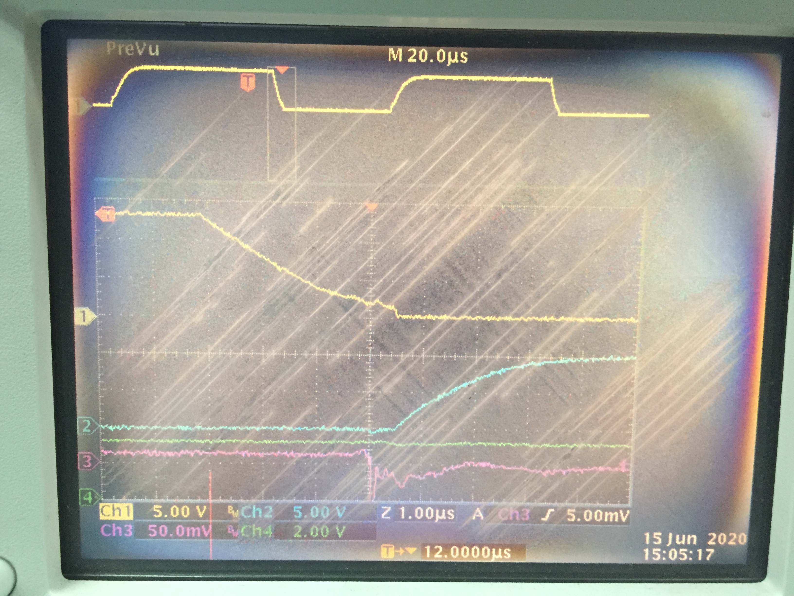

    There is the normal waveform as follows
    CH1   Q15 Vgs on high side FET
    CH2 Q15 Vgs on high side FET
    CH3 Coil current
    CH4 Q15 Vd on low side FET
    If operating at the lowest IDRIVE,I need more time to capture the abnormal waveform,

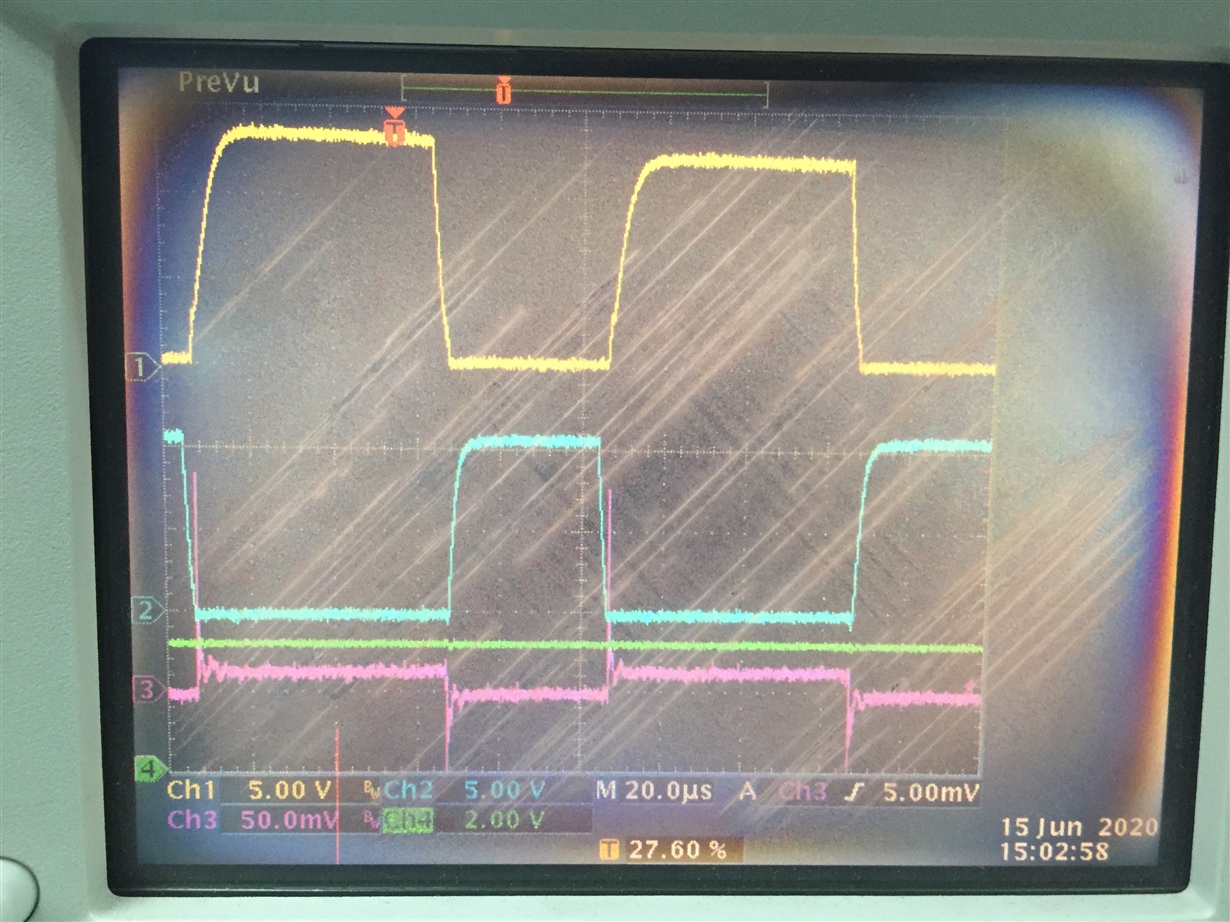

  • Hi Adam:
    This is the normal waveform at the lowest IDRIVE setting for both source and sink of all FETs
    CH1   Q15 Vgs on high side FET with differential probe
    CH4  ENABLE pin of  DRV8323
    Then there is another problem. In this case, the FETs switch is very slow, which may affect our control effect at 10K frequency.

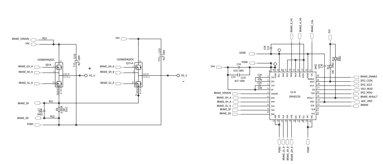

    Let me sort out my list of questions ,as follows:
    1. we apply to two-phase and three-phase at the same time, but there is basically no problem with three-phase, two-phase application often damages the FETs.I want to know if it is suitable for two-phase control
    2.Do you think there is something wrong with my schematic. I only use one amplifier in the two-phase control(SPA/SNA),and connect the SPB/SNB to the Ground
    3.The abnormal waveform in the first question, why the Vgs of the high side FET  rises when the lowe side FET is on,and in these two abnormal waveforms, we can see that there are some problems with the high side FET. I don't know if DRV8323 itself has a problem with the output or it is related to the peripheral circuit
    4.Will a too slow switching speed affect the dead time ?
    look forward to your reply
  • Hi Adam:
    I'm using the 3x mode, maybe I should use the independent PWM mode to control the two phases, do you think so, please check my schematic. If this is the case, what I don’t understand is that the 3x PWM mode can control each half bridge with INHx. Is it possible that the three phases affect each other, because I did not use the C phase in the 3x PWM mode, I look forward to your reply

  • ZX,
    You do not need to use the lowest IDRIVE but reducing from your initial value is helpful.
    I would try using independent mode and increase the dead time to ensure that you are not getting shoot through on the bridge.
    Your schematic looks fine but you may have some issue in your layout that is causing the high side gate to have trouble coming back down quickly and this is allowing the high side to remain on when the low side turns on.
    This effect should be prevented by the VGS monitors which should check if the high side is OFF before allowing the Low side to turn on.
    Are you measuring at the FETs or at the pins of the DRV?
    -Adam
