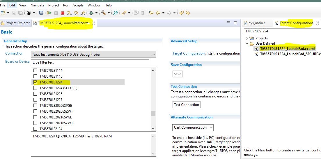

Good day!
After I've got the source project files for the DRV3205EVM board, I tried to run the program on the LaunchPad.
The compilation finished (CCS10) without any error, but the image couldn't be flashed afterward to the LAUNCHPADXL2-TMS57012 board.
I've got the following error messages:
"Texas Instruments XDS110 USB Debug Probe/CortexR4 (Disconnected:Unkown)"
"Texas Instruments XDS110 USB Debug Probe/CortexR4 : Target must be connected before loading program."
When I change the controller from the correct TMS570LS1224 to a TMS570LS1227 flashing works fine.
The only difference between the two devices is that the TMS570LS1227 has an additional FlexRay and Ethernet Interface.
What has to be done that the board could be flashed with the correct TMS570LS1224 type?
Thank you very much in advance for your help!
