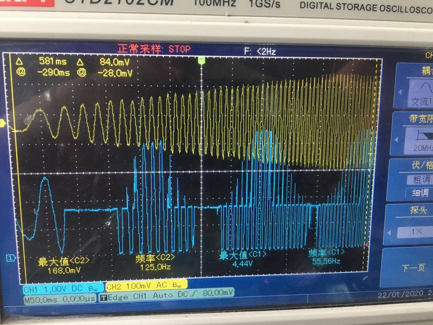

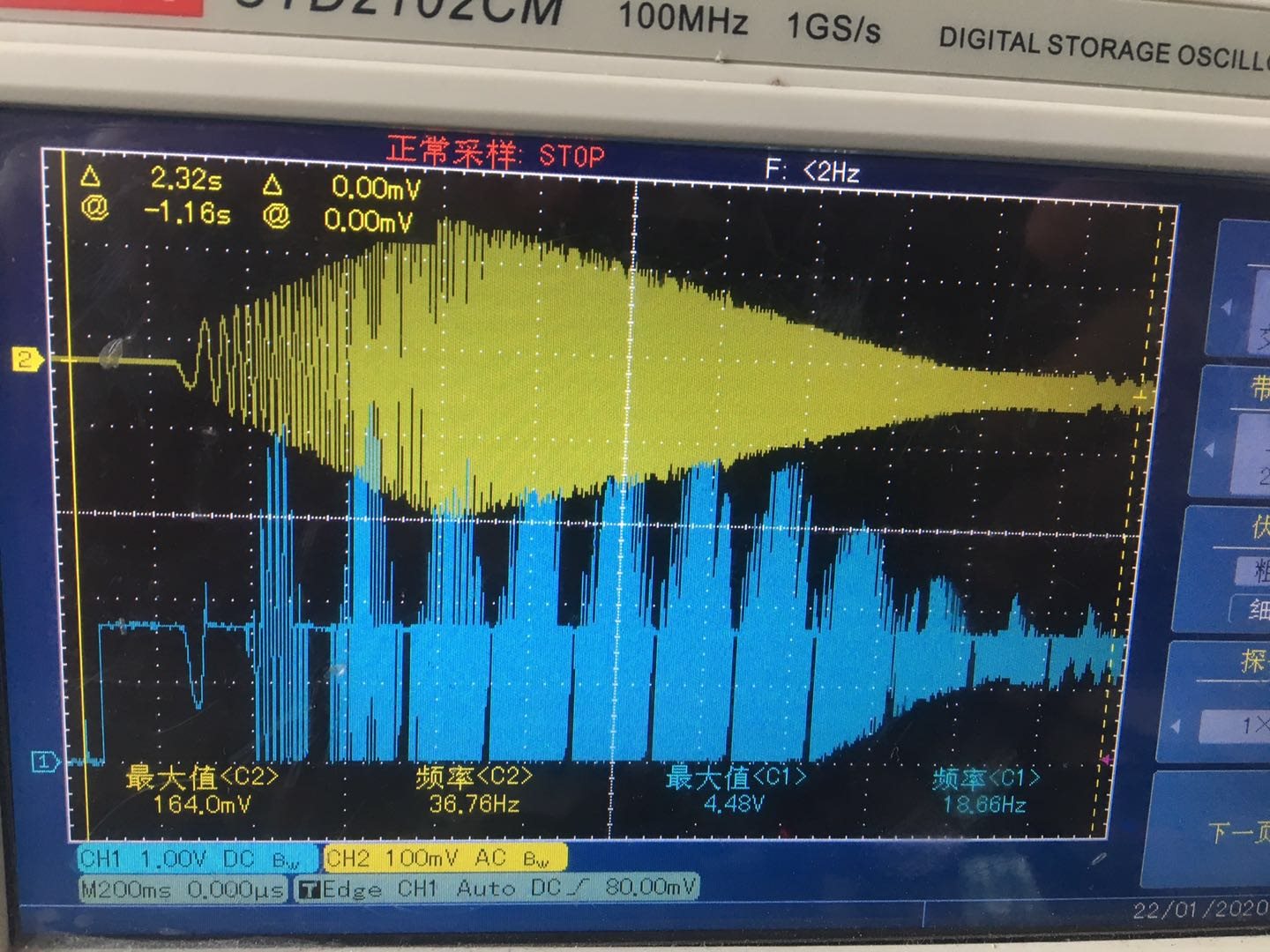

We measured the output signal of DRV8301 amplifier (SO1/ SO2), found the signal is abnormal during motor starting, it will become 1.65V and not tracking the input signal, please see Figure 1&2 for reference.

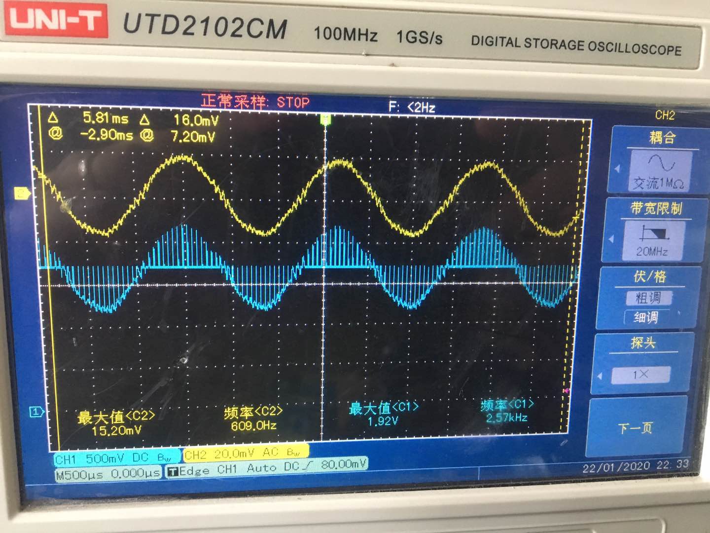

When the motor speed is very high, the output signal of DRV8301 amplifier seems normal, please see figure 3

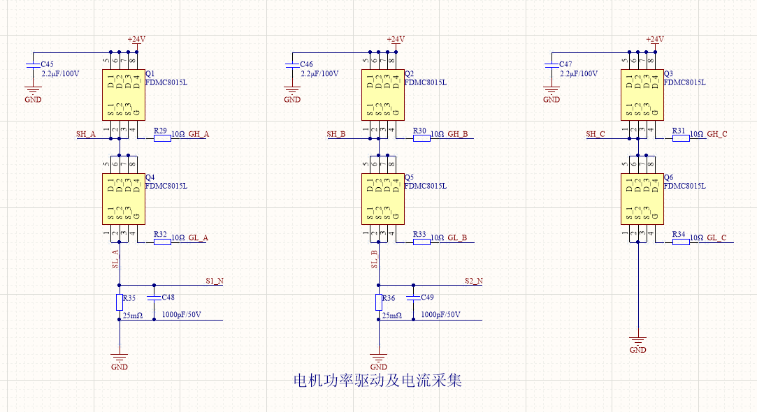

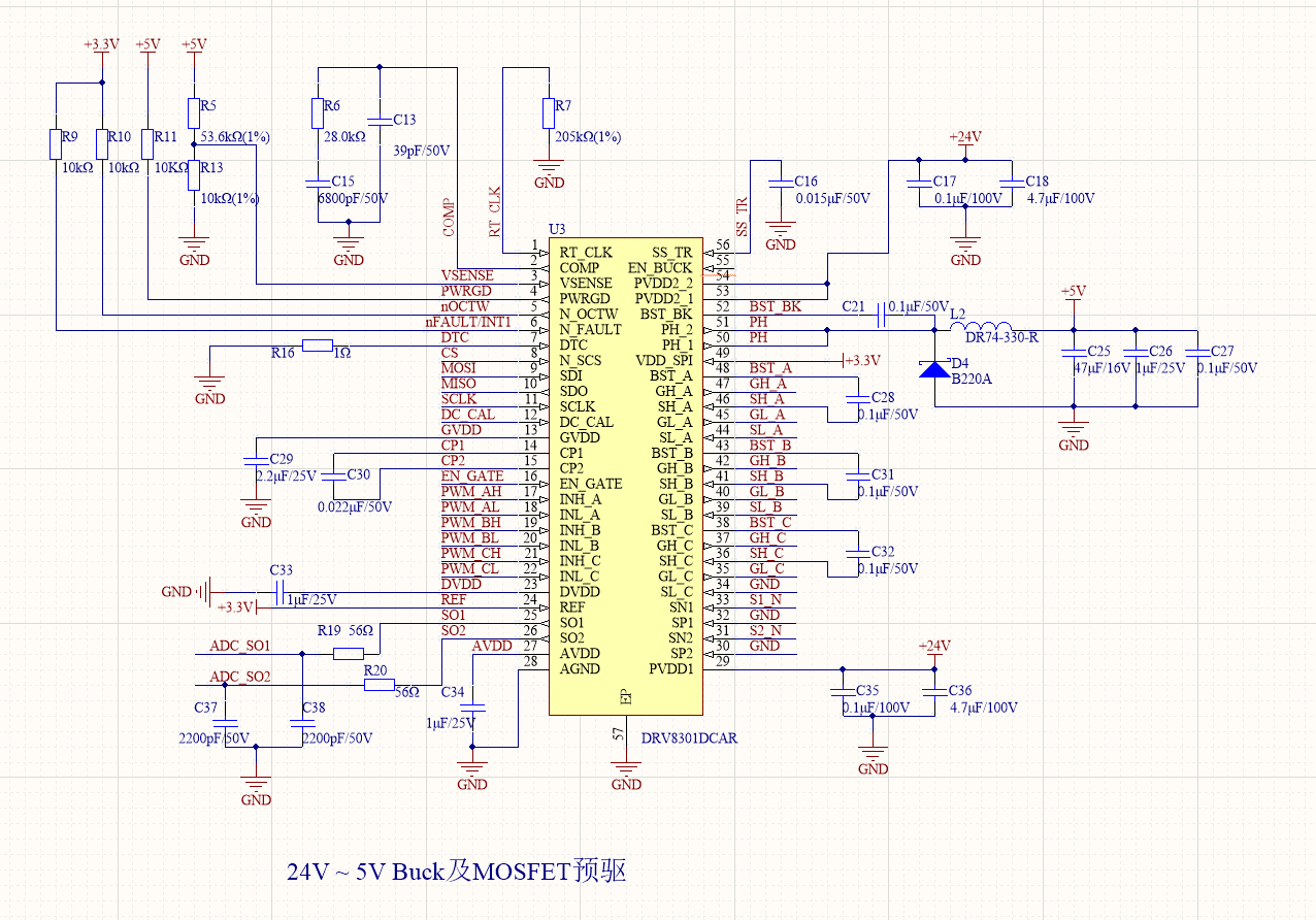

Figure 4&5 are the schematic.

The DC_CAL pin of DRV8301 already directly connect to GND in PCB, and no operation for DC_CAL by SPI.
SP1,SN1&SP2,SN2 are Differential pair in PCB.
The Gain of Amplifier is 10.
OC protection is disabled by SPI. (Enable or disables is the same)
Yellow :phase current, 1mv = 100mA
Blue :output of DRV8301 amplifier (SO1), SO2 is similar.
Figure 1 ,
Figure2 ,
Figure3 ,

    Can you plot figure 1 including the low side gate signal for the same phase? I think you are seeing the effect of the low side shunt measurement which works best when the low side gate is ON.
    -Adam
