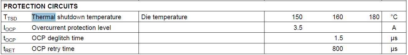

1. What is the condition DRV8188 trigger the thermal protection?
2. Which part of inner circurts may  trigger the  thermal protection?
    The datasheet lists the thermal protection threshold. When the IC temperature reaches that threshold, the thermal protection would be triggered.
    DRV8818 has integrated power FETs. In general, the power FETs should be the hot spot to trigger the thermal protection.
    3. Can you show me the data of save operating area of inner mosfet? The data of SOA about inner mosfets and other details about the mosfets.
    The minimum OCP current is 3.5A. Let us focus on the root cause of this failure first. What inner circuit gets the damage? What condition can cause that damage?
